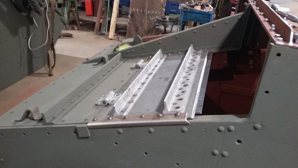

I've been quite busy making one of the drivers hatches and certainly very strong hinges

I needed some T section so I cut it out of some I beam I had and bevelled the required edges. This hatch is fully riveted with a lot of them. It was handy to use my hole punch and press them cold.

I used a 8.8 bolt for the rivet support which worked very well and a flat bottomed punch die to press a flat top.

It's finished and is a very good fit. Glad I only had to make one.

Hi Colin. The hinges look to be the same as those on a riveted U.C. folding flap
on the upper left side front armour. The have 2 inch hole centers.
Looking great as normal. Enjoying your thread. Keep it coming.

Is the driver's hatch a two part clamshell arrangement? The recent photos posted suggest the assembly you just completed would be a lower portion that would be opened last and closed first, with a heavier angled upper door lapping over it in the closed position.
If so, does the lower door simply rest open by its own weight, or does it lock open and closed? I suspect a counterweight system of some sort will be part of any upper hatch setup. It would be quite a head flattener otherwise.
