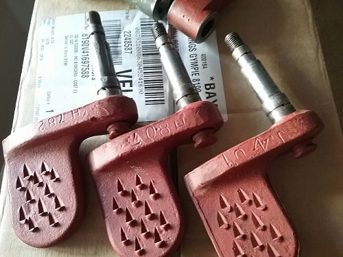

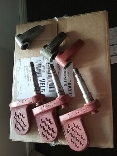

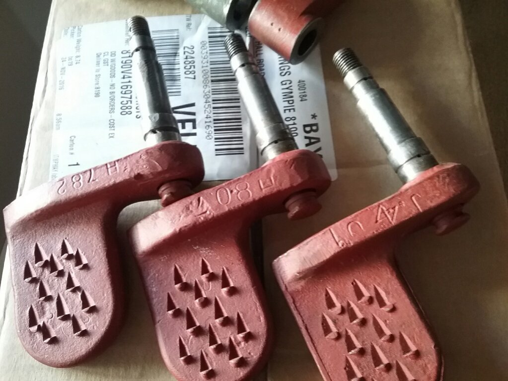

My most recent purchase was the above items. Quite rare items they would be too.
They are bigger, and heavier, than they look. You push the pedal down.....and the pawl raises up, allowing the withdrawl of the hand spikes from the tapered socket it locks into. Take a look at the next post to see what occurs if massive force is applied to one of these pedals without the pawl having freedom of movement.

So here are the three sets needed for each gun.
Look closely at the engineering which has gone into each pedal. It's VERY strong. A nice deap channel runs around the shaft, where i gather grease is provided. You also see the small hole right through the centre of each channel, affording better lubricant movement.

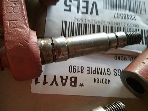

Now look what has occured to the hole through the shaft shown above. The hole has clearly been distorted by the twisting of the shaft at the weakest point, right through that hole! HOW MUCH FORCE WOULD BE NEEDED TO DO THAT!! Incredible. It's not a problem for me, because it doesn't impede functionality, but I can't get my head around what must have been done to this little piece. You will also note, there is absolutely no damage to the flat of the pedal itself. Why? Surely something that damaging would have left some trace of impact damage to the pedal surface, but there is nothing at all. Fascinating.

I would guess it has been seized and some leverage applied to free it. There is evidence of the shaft having been filed or similar as it doesn't look machined round anymore.

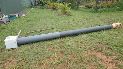

We have a couple 25 pounders (one normal, one as per funeral carriage) just 100 feet from my desk, so I walked over just now and snapped a bunch of photos of one handspike. I also measured this one and the diameter is 2.019, so there appears to be variation in the tube sizes. I'm guessing 2" tubing would be fine. I also found a pin holding the end cap on, and note the endcap appears to be brass.
Of the four handspikes in this location, one of them does not have rivets. I did not have a closer look to see if they are merely burnished flush or if the ends are welded on.
Here are the shots next to a tape. (the tape may have shifted a little in the second photo).
