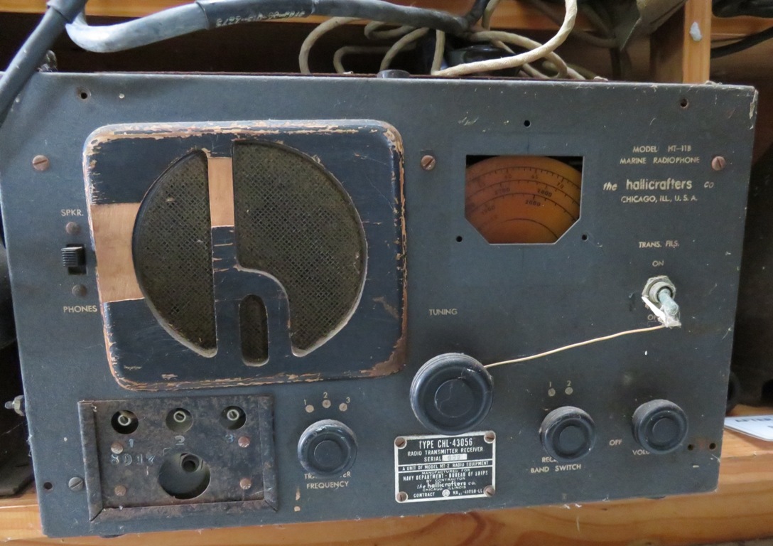

Default What do I have here? No.9.
This is another USA Navy Bureau of ships unit I know nothing about.

The US Navy called it the MT-2 but the Hallicrafters model was HT11. It was designed as a civilian marine band radio but later adopted by the military. Here's some info on it's use with the Canadian Navy.
http://jproc.ca/rrp/ht11.html
