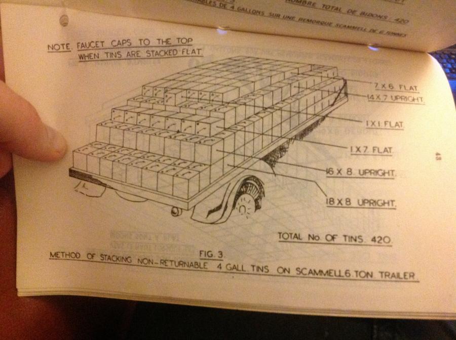

Before i post some of the US Jerrycans, can any of our British Commonwealth friends post pictures of their country's period water and petrol cans as they were carried on their country' s Carriers for comparison to the Canadian practice please ?
Lauren, as far as local 4 gallon cans , i think you were alluding to what was / is called '' flimsy's '' , am i correct ? Post a few pictures please so we will be able to see the great advantages of the jerrycan vs the flimsy for a mechanised army in campaign.
Let me state a few : 1 gal more content. Reusable infinitum. Can be carried in pairs no problem by one man.
Many thanks.

Blitzkrieg is OK but you missed the boat on obsolescent.
Old 04-01-16, 09:05
While it is "get Robert time".
Have you fueled up your carrier from a Jerry can, "without a funnel etc", yet Robert? (no pourer allowed sorry) (you technically ruled it out with the "etc")
You second to last line refers to "carrying two Jerry cans by one man, no problem". You must mean empty ones!?
I was on exercise in Fiji in the early 70's. Every one was carrying gear. I was tasked with carrying a modern standard plastic 20 litre water container (full of drinking water) up a big hill. A long climb. I was wearing my webbing and a pack full of gear, along with the SLR (L1A1) and I will never forget having to carry that bloody thing.
Remember "gas" (petrol) has a S.G. of 0.76 or there abouts. Water is 1.00!
Don't give me "no problem!"

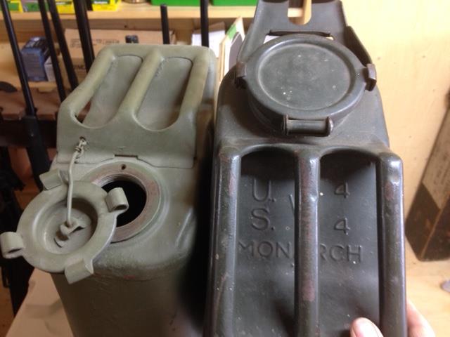

Here a few examples of the US Jerrycans , fuel and water and they are radicaly different from either the Canadian or the British versions .
Lastly, the issue has not evolved much in the last 75 years because here you have a modern, current Canadian water can / Jerrycan . It is made of plastic, it is black and it weights a lot when full. Better suited for vehicule mounting than being carried by light infantry in the mountains of Afghanistan.
So, coming back to the initial subject. Carrier crews would mount whatever they could get their hands on to carry as much fuel and water to last till the next replenishment. It could take quite a while. 2 gal, 5 gal Brit / US Jerrycans you name it.
In my humble opinion the US 5 gal water Jerrycan was the best because of the large mouth . Unfortunately i see no photographic evidence they were ever used by the Canadians. It is better and the evidence to that is that it is still largely employed today in the form of the plastic example i have posted. They are also made sand desert colour.
As far as the fuel container , the British 5 Gal Jerrycan was better. The US Jerrycan really needed a funnel to work . Anyone wants to add on this ? I am open to critisizim but please , please let's stay gentlemanly.
I am still curious to see what Lynn , Lauren ( thanks for the nice 2 gal can pictures ) and the other folks from the Commonwealth are going to post for pictures of 4, 5 gallon cans and flymsies so we can compare with the Canadian Carrier experience . I am really interested .
Picture 1- Left 1944 US gas Jerrycan right 1944 US Water can. Picture 2- 1944 gas Jerrycan. 3- Current Canadian water can. Used from the mid 80's till present day.

Flimsy type (non-returnable) from RASC training pamphlet 20 part 2.
(note this is a document on Petrol, Oil, and Lubricants, not water, so just quoted here to demonstrate the difference in the cans)
4 Gallon returnable (late flimsy)

4 1/2 gallon Jerricans
