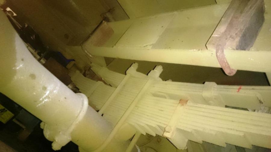

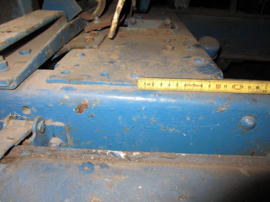

I am trying to ID a Chevrolet: it is said to be a C60S, but it is on 10.50-16 tyres, which could mean it is a C30. But it does have helper springs on the rear axle and the front axle knuckle has 6 bolts on top.
Not very good quality pics, but they show the 6-bolt steering knuckle ("heavy" or 3-ton axle) and rear axle helper spring. Tell-tale signs of a 3-ton C60S, rather than a 30-cwt C30, right?
Do 16" rims fit on 3-ton axles/drumbrakes?
Chevrolets are not my strong point, sorry
Thanks,

Hanno, I think it's a misnomer to describe CMP axles in terms of load rating. Certainly within the 60L/60S range there's no correlation with componentry such as steering ends or steering box. These appear to be nothing more than design upgrades - early production 60L/60S had small steering ends and steering box, while later production 60L/60S had large steering ends and steering box. I'm not sure exactly when the changeover occurred in Canadian production, but it's not seen in Australian assembly until mid '44, and even later in Indian assembly I believe, perhaps around mid '45. Hence a very large proportion of Australian and Indian assembled 60L/60S/FAT were fitted with small steering ends and steering box.
As we know of course, the 15A retained small steering ends and steering box universally, however I'm not sure that's true of the C30/F30. I've seen at least two F30 ambos in Australia with large steering ends and steering box. As far as I can make out, the only SPECIFIED difference between C60S/F60S and C30/F30 is wheel size. This gets back to our earlier discussion concerning CMP load class rating, which appears to based solely on wheelbase and wheel size.
On the question of auxiliary springs - they're definitely specified in the Ford workshop manual, and while it's not the most dependable source of info, you'd certainly expect auxiliary springs on the C30/F30 Derrick and LAAT. I'm not sure about the various ambos, but it occurs to me they may have been anomalous in many respects.
And yes, 16" and 20" wheels are fully interchangeable, with no difference b/w Chev and Ford.
Tony,
Agree on the misnomer to describe CMP axles in terms of load rating, that is why I also use the "heavy" and "light" designations, by which I mean the same as your "large" and "small" designations. When I write "3-ton axle" I mean to say "the type of axle fitted to a truck with a 3-ton load rating".
Indeed the factory specifications do not specify a load rating for the axles themselves. But, next to wheel size they also list the differential ratio and number of spring leaves. It is this combination which was required to match the specified load rating for a certain type of truck. The C60S and C60L are thus fitted with 20" wheels, 7.16:1 differential ratio and 18 (12+6 aux.) spring leaves on the rear axle, which enables them to carry a 3-ton load.
So in the case of the subject vehicle, does the fact that it has "heavy"/"large" steering ends (the type with six bolts on top) means nothing to identify it? Or is it the case that an axle with "heavy"/"large" steering ends always has the 7.16:1 differential ratio?
One fact which helps to ID this truck is that it is fitted with 18 (12+6 aux.) spring leaves on the rear axle, which was fitted to the C60S and not the C30 which had only 12 spring leaves on the rear axle. As per factory spec it should thus be fitted with 20" wheels and not the 16" wheels it currently has.
In order to answer that question Hanno we'd need to know Chev practice with the C30, which can only be confirmed by checking wartime photographs and surviving examples. If you find the C30 retained small steering ends universally, just like the C15A, then the large steering ends would identify this vehicle as C60S. On the other hand, if the C30 steering ends were upgraded in later production, just like the C60L/S, they would not be definitive.
My own belief is that the C30 would have retained small steering ends, just like the C15A. Certainly this appears to be the case with the F30 chassis in Australian ambulance use. These were very late production chassis, and they differ greatly from late production F60S chassis supplied to Australia. Based on my own observations:
late production F60S: large steering ends, large steering box, auxiliary springs, reinforced chassis.
late production F30: small steering ends, small steering box, absent auxiliary springs, non-reinforced chassis.
Interestingly though I have seen ONE ambulance chassis which is late production F60S in every respect except absent auxiliary springs. For the moment I've dismissed this chassis as anomalous, perhaps reallocated from F60S production, however it may not be the only one.
On the question of diff ratio - normally this correlates with wheel size: 6/39 diff with 16" wheels; 6/43 diff with 20" wheels. On that basis the C30/F30 diff may seem anomalous, however the C30/F30 ran much bigger tyres than the 15A, so it's not a direct comparison. More importantly perhaps, the 2-speed transfer case would call for the more robust 6/43 diff.

Interesting discussion guys. Now, concentrating on Chevrolets for the moment as I am trying to ID a C60S or C30 on 16" wheels.
I just looked up some more facts in the Chevrolet MB-C2 maintenance manual and list my findings here:
Front axle:
6” steering ends (”steering arm is a separate part and attached to the lower part of the knuckle by six cap screws”): C60S, C60L, CGT
5” steering ends: C8A, C15A, C30, ”and on some special equipped C60L vehicles”
Brakes, front drum:
15” diameter, 3.5” width lining: C60S, C60L, CGT
14” diameter, 2” width lining: C8A, C15, C15A, C30
Brakes, rear drum:
15” diameter, 3.5” width lining: C15A, C30, C60S, C60L, CGT
Brakes, booster actuated:
C60S, C60L and CGT
Wheel sizes:
16” rims: C8A, C15, C15A, C30
20” rims: C60S, C60L, CGT
Differential gear ratio:
5.43 to 1: C8A
6.17 to 1: C15
6.5 to 1: C15A
7.16 to 1: C30, C60S, C60L, CGT
Springs:
As per factory specifications.
Winch:
Standard on CGT, supplied as optional equipment on C30, C60S, C60L.
Steering gear
Ratio is 23.6 to 1, with the exception of C60L with Gun Portee or Petrol Tank which has a ratio 30.6 to 1
C8A, C15 have mounting different from all other types
Old 07-11-14, 21:47
Posts: 14,974
Translating the above to identifying technical specs per vehicle type (limited to C30 and C60S as this the object of our discussion):
C30:
  • Front axle with 5” steering ends
  • Brakes, front drum: 14” diameter, 2” width lining
  • Brakes, rear drum: 15” diameter, 3.5” width lining
  • Wheel size: 16” rims
  • Differential gear ratio: 7.16 to 1
  • Rear spring leaves: 12
C60S:
  • Front axle with 6” steering ends
  • Brakes, front drum: 15” diameter, 3.5” width lining
  • Booster actuated brakes
  • Wheel size: 20” rims
  • Number of rear spring leaves: 12 + 6 Aux.
So the Chevrolet I am trying to ID is a C60S, by virtue of having:
  • 6” steering ends - see the picture with six cap screws
  • 12 + 6 Aux. rear spring leaves - see the picture showing the auxiliary springs
  • True, it is fitted with 16" rims, but it is possible to fit these on 15" diameter brake drums (C15, C30 have 16" rims on 15" diameter rear drum brakes)
Now, if I check if the subject vehicle has (had) a brake booster, I am sure this is a C60S rather than a C30.
Riddle solved!

Hi Hanno,
Apologies for the late response, been a bit busy recently. Having read the conclusions on the differences between C30 and C60S chassis, I have to add that certain C30 chassis were actually fitted with brake booster systems, although it's NOT shown in MBC1 or 2, nor is it mentioned in the parts catalogue!
My C30 LAAT (20/08/1942) has the following :
  • Small 5" knuckles
  • 11 leaves in the front springs
  • 12 leaves in the rear springs, + 4 helper springs
  • Brake booster and additional riveted brackets on the chassis.
I have to say that the brakes work really well on stopping 4.5 Tons of Chevy.
I'm sure Rob Fast in Canada has a C30 of a similar year, so maybe he can verify the above info.
Best regards

Old 07-12-14, 00:07
Posts: 14,974
I find the best way to think about CMP frames in general, be they Ford or Chev, is to consider the siderail as 3 separate sections: front section, rear section, midsection - the latter being straight channel. All front sections are identical, and all rear sections are identical - it's only the midsection that varies, and only in length, according to wheelbase. No doubt this greatly simplified production, and may have been standard industry practice in truck manufacture.
Niels was so kind to measure up the chassis of his CGT and C30 trucks - please refer to the attached drawing from the Chevrolet manual to which I added red lines at datum points "C", "D", "E" and "F".
Name:	Chevrolet CMP Frame dimensions_redlined.jpg
He reported the following frame height dimensions on the outside of the C30 frame rail:
C: 20 cm
D: 20,5 cm
E: 18 cm
F: 14,5 cm
On the CGT it was bit hard to get the measurements, but from what Niels could tell they where the same as on the C30.
As the distance between "C" and "D" is the same on all chassis (transfer case is fitted to cross member "D"), this means the difference in chassis length is in the mid-section "D"-"E" as follows:
C30: 150 cm
CGT: 73 cm
The difference between the two is 77 cm. I would expect it to be equal to the difference between the wheelbases: 134" - 101" = 33" = 83,8 cm, so there may be some more measuring up needed.
Tomorrow I will post some of the pictures Niels made.

Pictures of chassis at datum points "C" and "D", plus dimensions:
Datum point "C" (at tip of pen), right hand external view (left) and right hand internal view (right).
Frame height is 20 cm at this point:
ID:	69602 Click image for larger version
Datum point "D" - the transfer case cross member - left hand external view (left) and left hand internal view (right).
Frame height is 20,5 cm at this point:
ID:	69604 Click image for larger version
