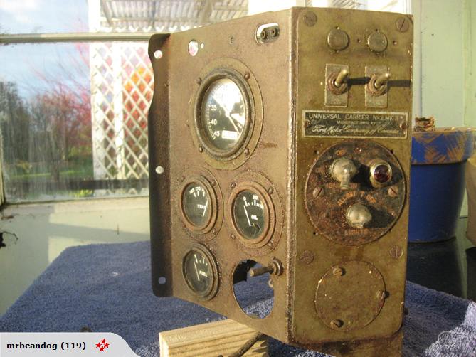

Default MkII* Ford Canada
Stole this pic from Trademe. The guy selling it bought it in the U.K.
I've never seen or heard of a MkII in N.Z.
Old 17-08-10, 06:26
Philliphastings's Avatar
Join Date: Feb 2004
Location: Sunny Australia
Posts: 528
Default Mk11 panel.
you're just teasing Lynn...
Mind you is it was a Mk1 panel I might sign up to trade me and have a go at it.
