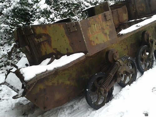

hi fella's

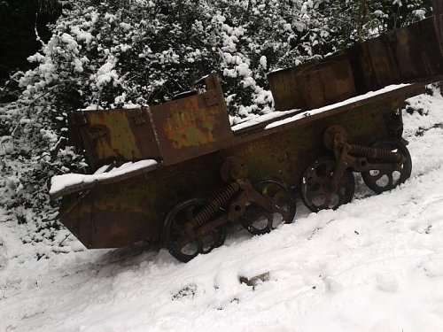

i finally got round to starting the restoration on my t16, i bought it a while back from a dealer in staffordshire with the understanding that i could store it at his yard until i was ready to tell the wife i'd bought another carrier but my little lad grassed me up a week later anyway it just took me this long to get round to starting it.
i got a mate to drop it off at my workshop a week ago on monday, the first couple of days were spent cleaning out all the crud and cutting out the rusted plate i then measured up and ordered the cutting list from the profilers. next we'll get welding the patches up.

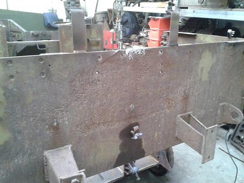

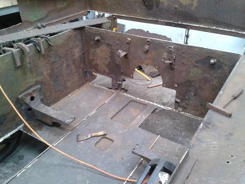

hi bill you can probably see what's there and what's not but i have been collecting parts for quite some time and all i really need to get the basics up and running is two wheels for the front idlers.
the tub was a little out of shape due to the sides being cut and the generally poor condition of the floorpan and sponsons not to mention the engine and chassis rails because of this i've had to pay attention to the lines before welding the plates back in, not really difficult but it does slow the job down.
in the pics i needed to pull the rear armour plate before i could weld the rear sponson, so i welded a bracket to the back plate (it's actually a churchill track idler tension shim) and used a hoist to pull it before tacking it.

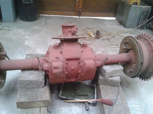

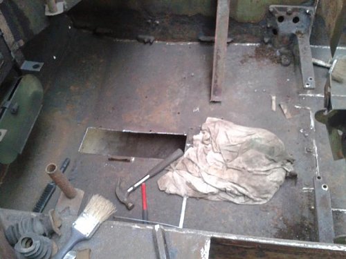

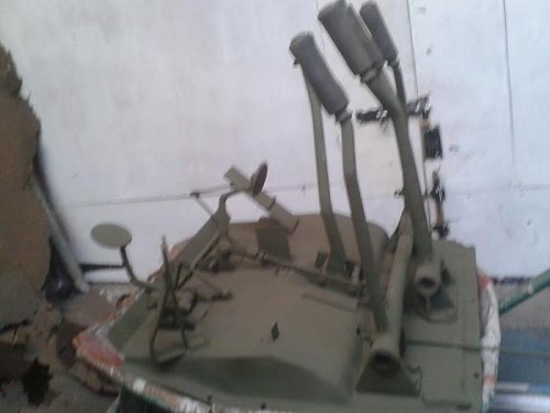

managed to do a little bit more on the carrier last week. the under side is now de-rusted and painted and although it's no big achievement it's really nice to see a bit of green on it at long last. the 2 left hand suspension assemblies have been removed for blasting and painting, i was worried that i would be in for a fight trying to get them off but they slipped off as if they were fitted yesterday.
the axle will need to be stripped down and de-rusted for although it was a new assembly it wasn't filled with oil so there is surface corrosion from condensation but at least the pinion backlash will still be factory set so it's just a case of wire brush then fill with gear oil.
i had the controls professionally rebuilt and i'm pleased with the result, to be honest i doubt i could have set them up properly myself as the linkage is quite complicated and the tolerances don't allow for guestimating.
i hope to get it looking something like with the tracks on by the end of the month but then again i am a little over optimistic at times .

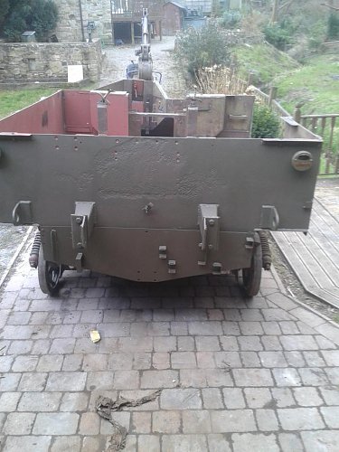

bit more progress

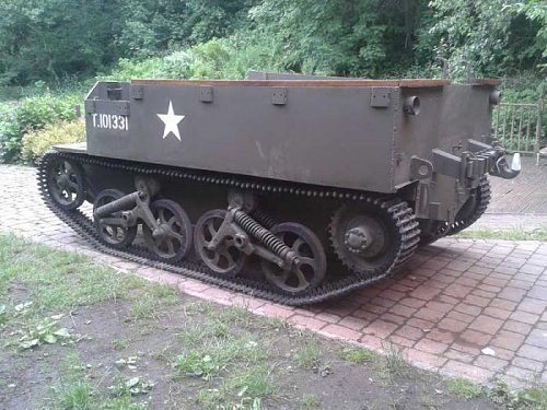

... and it's finished, ready to be sold!
Quick job you made of it, Rick, looks nicely done
1943 T16 Universal Carrier
T16 with original War Department number.
Has had ground up restoration. Fitted with good tracks and NOS axle. Brakes steering and clutch fitted and working, but engine will require rebuild. Good engine possibly available by separate negotiation. An easy project to get running in time for War and Peace Revival. Selling to fund a bigger project.
£15000 ono.
