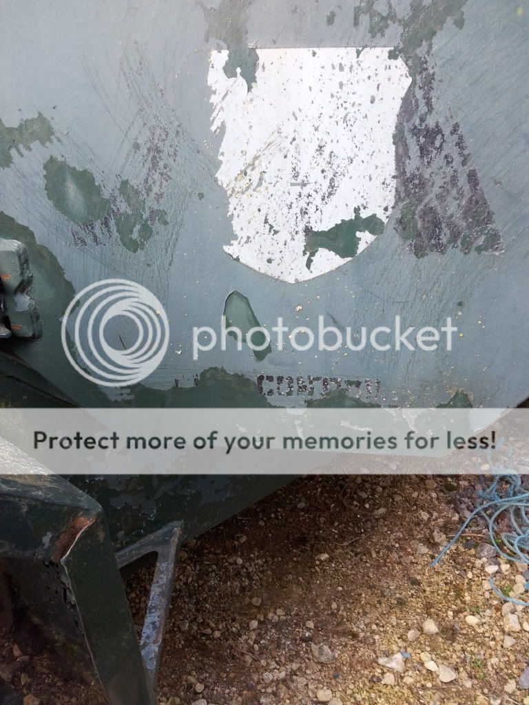

No idea on TV or Film debute but was in Grey with Shields on Doors saying...'Something' CONTROL??? Also some kind of Tressle or Castlement Icon in Black behind shield????????????????
Makes me think more like a Bank Truck...Brinks Matt type thing, but Guessing Big Time!
Tyres and text visible to date

Saw Piggy on 28th March and noticed a few things, but did take two batteries and connected up. Got an ignition panel light and she turned over................
Isolated the fuel as what was in one tank smelt like old gloss paint in a tin???? The fuel filter was fuel of old fuel, but no filter?
I had identified something in the rear storage locker under floor that transpired to be these items.
Lots of other images taken to follow;
Wayne
1959 Royal Ordnance FV1611A
  #60
Old 02-04-12, 00:18
FV1611A's Avatar
FV1611A FV1611A is offline
Wayne
Join Date: Nov 2010
Location: Ross-on-Wye, Herefordshire UK
Posts: 69
Removing an awful lot of Gunge and it was evident that a historic custodian (Not PO) had painted some parts in the engine bay in DBG as I guess he didn't want to buy some SKy Blue?
The internal relay and switches cover identified a couple of non standard alterations?
