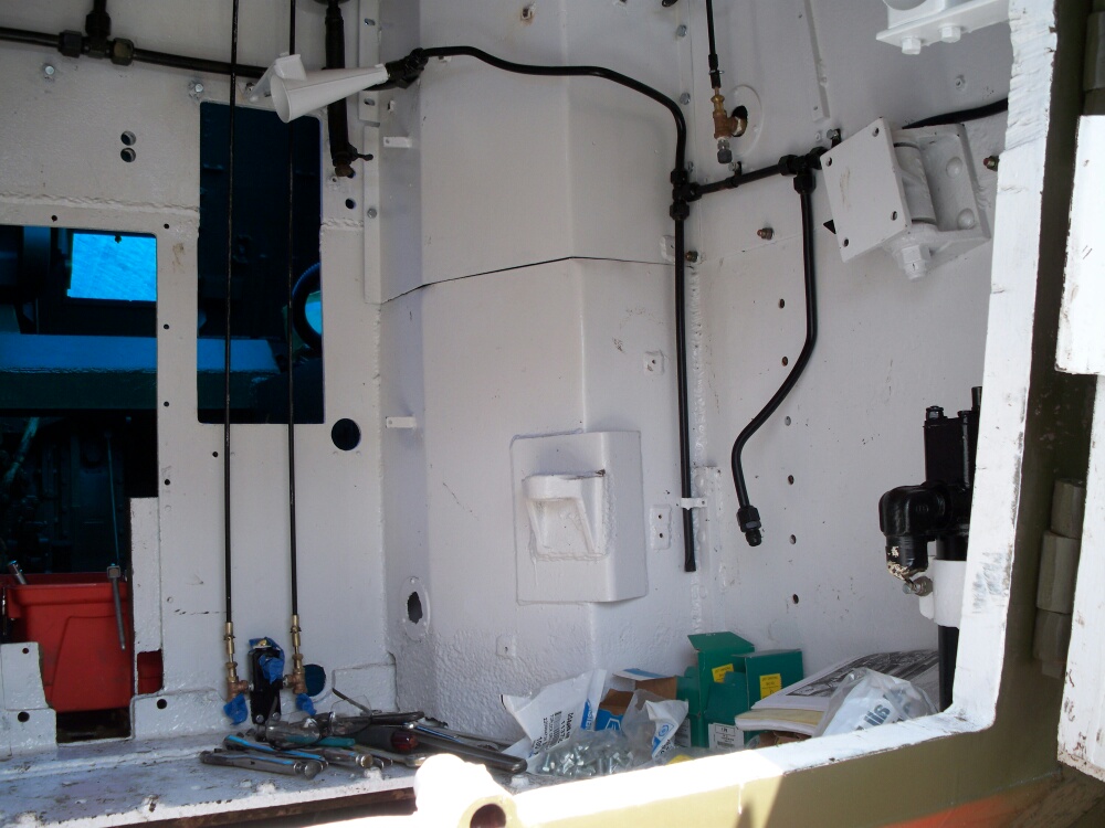

Just about ready for the engine. Unfortunately, the engine is not ready. We should get the remainder of the parts for the engine on Monday. Jesse.
100_0860_resized.jpg   100_1908_resized.JPG   100_1179_resized.JPG   100_1481_resized.JPG   100_1532_resized.JPG

May be running this week. There is still one bad cylinder. It was dropped somewhere along the way, and needs to be welded. Jesse.
100_1565_resized.JPG   100_1572_resized.JPG   100_1580_resized.JPG   100_1411_resized.jpg   100_1404_resized.jpg

Firing it up Monday morning.
100_1586_resized.JPG   100_1596_resized.JPG   100_1584_resized.JPG   100_1600_resized.JPG   100_1599_resized.JPG
