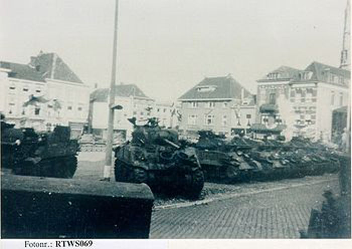

It seems this defrocked Priest was a beloved photo-subject. The following shots are from the Bergen op Zoom city archives.
Source: http://www.markiezenhof.nl
Old 07-02-08, 15:50

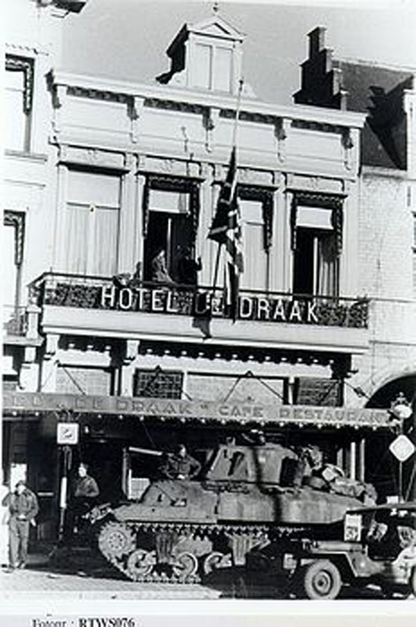

And the RAM OP Hanno was referring to..
Hi Alex;
Reference your third image of 'Priest' Kangaroo T214613. On 29 August 1944, 'Priest' Kangaroo - WD No. S214613 - was issued to: 10 Cdn Inf Bde (4 Cdn Armd Div) - from: E Sqn, 25 Cdn Armd Del Regt (2 Cdn Corps).
Mark
Now that is not very nice.

Old 09-09-09, 21:40
Hotel De Draak is still there, the Ram OP isn´t. . .
By the way, De Draak (The Dragon) is the oldest hotel in the Netherlands. How old? Well, it was one of only two buildings which survived the great fire of 1397. . .
Pic with my phone taken last July when I was there and happened to recall that location. Although the town square is quite large, all the medieval roads leading to it are narrow. It must have taken quite some effort to get all those vehicles there, and I can´t see the reason why, other than to show that one has taken posession of the town.

I believe this photo is also of the same line up from the first photo. Except that the RAM OP has now moved up to be in line with the other tanks and the jeeps have moved.
