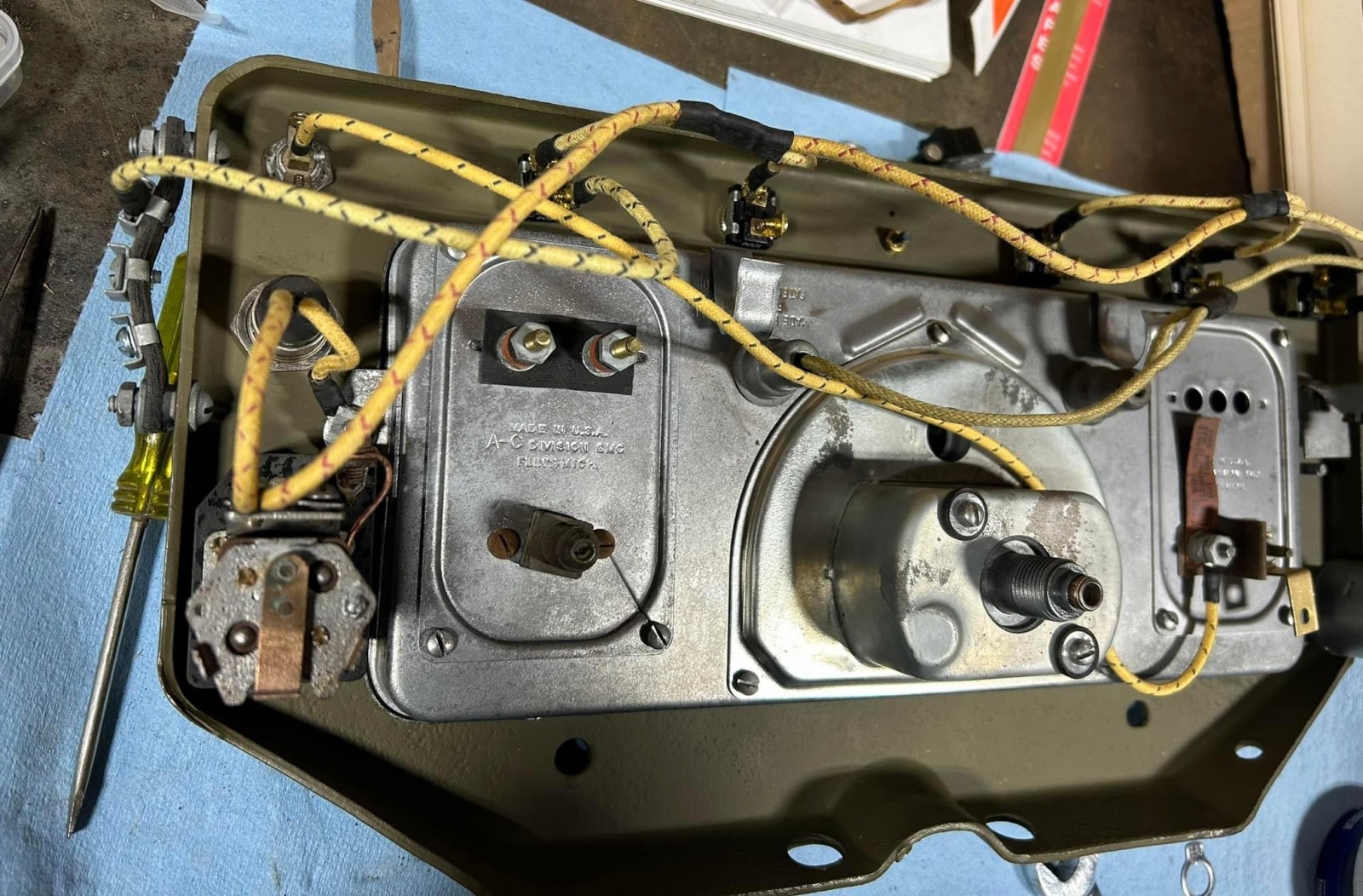

The dash rebuild is moving along nicely. The next few posts will be photo heavy with a handful of “before and afters”
First up is the dash as it looks now. The pitting was filled with some jb weld and then carved and sanded down until it was smooth again. The gauge cluster will not be the original one as it was sadly too far gone with the entire bottom portions rotted away.
The second picture is of the parts I’ve rebuilt. See the next few posts for more details on them. The circuit cut out cleaned up quite nicely after vapour blasting. I haven’t tested it yet but it’s on the list to look at.

  #255
Old 06-10-23, 11:57
Default Mystery object ID
It might be a voltage reducer... One source lists the otter as 12 volt system. using a voltage reducer would permit use of a 6 volt gauge, common to other CMP... More research is needed.
A photo of a current version https://vintageautogarage.com/electr...RoC1zQQAvD_BwE is attached. They are also referred to as Runtz https://oldchevytrucks.com/catalogse...esult/?q=runtz
  #256
Old 06-10-23, 12:23
Otter parts list CRAC-02 lists part 862138 "adapter, fuel gauge" on page 123 (group 9.7312). There is also "adapter. heat indicator" part 1510678. I've no idea why they list 2 different adapters if they are the type of voltage reducer I'm suggesting as current practice is to use one version for low current devices like gauges and a different version for higher current devices like fan motors and radios. It seems the high current versions give bad gauge readings...
Although they don't have the * that commonly means unique to CMP in the parts list neither of those part numbers show in the 1929-1948 Chevrolet Master Parts Catalog. Also no result in GMpartswiki.com
On edit: In an effort to confirm or deny my idea, I just thought to check the part number of the fuel gauge mounted on the dash - it is the same part number as listed for the C60S. For the heat indicator, the C60S uses a mechanical gauge and the theory about voltage reducers only makes sense for an electrical version.

Dash is coming along. The speedometer was replaced but it needed a rebuild. I also decided to reset the odometer to match what was originally removed from the Otter. The wiring junction block was also rebuilt and plated.

I think Grant is bang on, that it is a voltage reducer. The resistance needs to suit the load. Macs have them for individual instruments, 12 volt to 6 volt.
