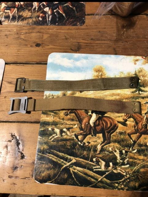

Default Pioneer tools installed
Today i installed some NOS original Canadian canvas straps to hold the shovel and pick axe . Used the original scews i had to fight with but managed to break loose . Nice addition to the truck especially the shovel : Original WW2 Bulldog .

Upper picture : P-37 Canadian strap . Lower strap : Original Canadian vehicle equipment / utility straps as found on these trucks . Found a nice lot of them last summer somewhere in Canada .

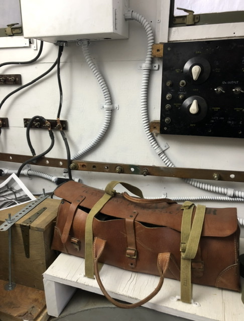

Rifle butt sockets installed . Antenna accessories leather valise installed on the shelf . It is to heavy and cumbursome to go in the shelving cabinet . It contains antenna spikes , isolators and a big hammer . It must weight 45 Lbs .
3E41254E-E988-44EF-BDA2-4C18A3F11E0D.jpeg   0046D7CC-CE7B-4748-A9A6-55E7AF98DE7F.jpeg
It looks a bit over-full. (I think the flap should close more than that - both of mine do.) According to the working instructions, the bag should contain:
Guys, Assembly ZA/C 00022 Qty 8
Hammers, 4.1/2 lb. striking Qty 1
Hammers, Engineers, Ball Pein. 8 oz. Qty 1
Leads, Aerial No. C6 ZA/C 00102 Qty 1
Pegs, Antennae Rods "A" ZA 0374 Qty 8 + 2 spares
Spikes, Ground ZA/C 00024 Qty 2
...which will be heavy enough, since the forged steel ground spikes are very heavy, but there's probably other bits of the vehicle hardware mounting kit crammed in there as well that should be in its own bag. Mine had the aerial base and a halyard, plus a multi-section wire aerial that looked to be a replacement for the WS19 kit of 6 aerials (but was cut to the wrong length) on a wire-frame winder, tipped in.
I think the best place for the Bags, Aerial Gear, Mk.II is on the bottom shelf of the cabinet (i.e. at floor level) to keep the c.g. as low as possible.
Best regards,
Chris.

Down here Chris ?
