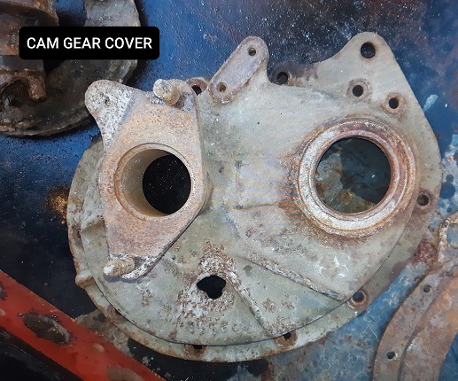

Cam Gear Cover - Ideally without bullet hole.
