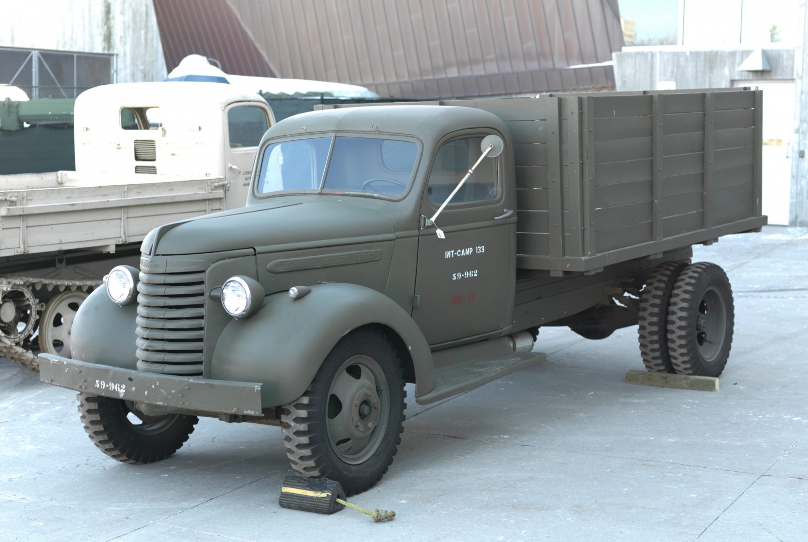

Default GMC 9543 2-Ton truck
Not trying to muddle the water, but compare the Chevrolet 1542 with this 1940 "GMC 9543" 2-Ton truck at the Canadian War Museum.
ID:	118787 Click image for larger version
https://www.warmuseum.ca/collections/artifact/1317585
Old 04-01-21, 02:39
Mike K Mike K is online now
Posts: 6,015
Default Gmc
GMC's could be described as being heavy duty Chevrolet's, the GMC engine is a different beast compared to the basic Chev engine , it is a more refined motor with, I believe, full pressure big ends.
