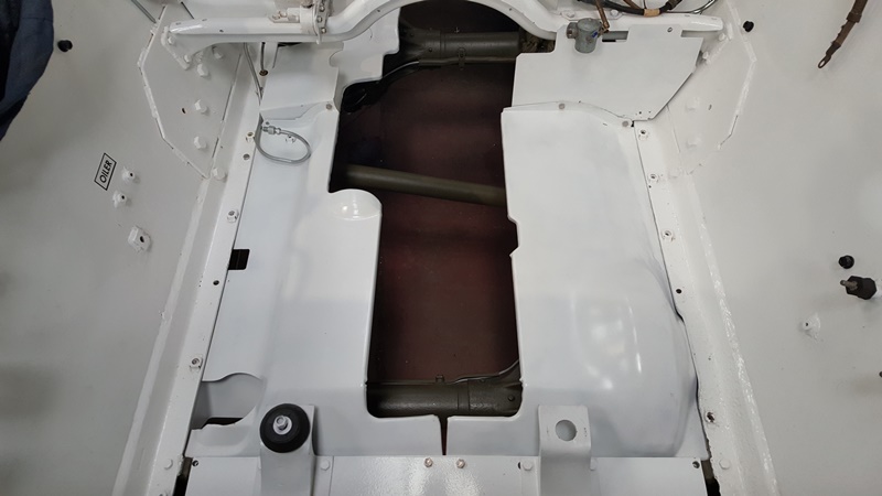

As far as the M8 goes, here are a few photos of the lower engine panels temporarily fitted into place so you can see how they are arranged. I think I will leave the small panel under the fuel tank in there prior to the fitting of the engine. It is not the easiest of things to fit into place. The other panels can go in once the engine is fitted and everything is looking good.

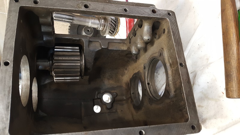

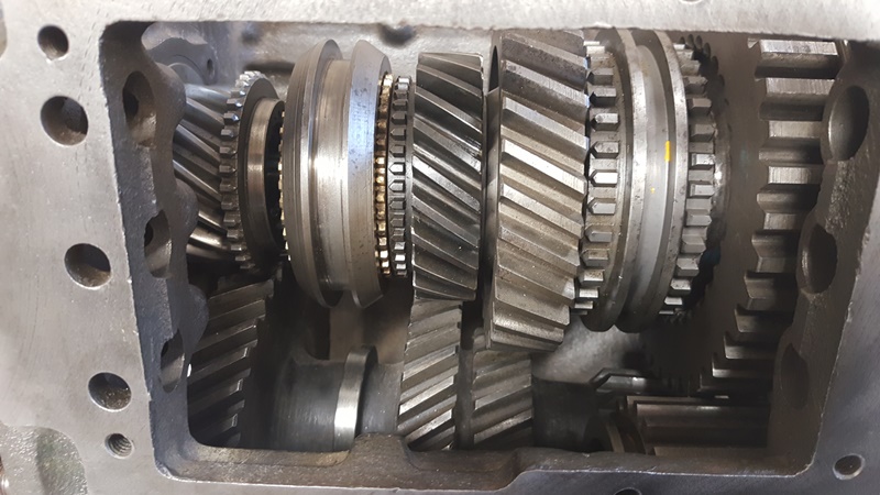

The gearbox assembly was an interesting exercise. You will recall I had to replace all the synchro rings and third gear so I had to completely dissemble the mainshaft. The mainshaft is reassembled on the spline in this order: Second gear, thrust washer, 2nd gear synchro ring, synchro hub assembly, 1st gear synchro ring, 1st gear, reverse gear.
I had a retired mechanical engineer give me some assistance which was great as he had rebuilt countless gearboxes in his career and at times during this rebuild I found two heads were better than one with a couple of little hurdles that I struck.
The main problem I had was that the new 1st and 2nd gear synchro hub assembly was a very tight fit on the mainshaft spline. The manual refers to ‘sliding the synchro hub assembly’ onto the splined shaft during reassembly. These hubs were never going to slide on. The old hub had to be pressed off and the new one had to be pressed on and we tried various methods in doing that, with the first gear down on the press and then first gear upwards on the press.
The difficulty with pressing the assembly on was that you had little control over the thrust washer and 2nd gear synchro ring positions once the process of pressing the assembly on started. The slightest movement of the first gear or the shaft would change the position of the thrust washer and then the teeth on the synchro hub assembly would not align properly with the thrust washer meaning the hub had to be pressed off again. The other problem was that if you pressed the hub assembly on with first gear down (shaft into hub), you couldn’t control the position of the synchro ring and this had a tendency to cant on the shoulder of second gear, at the last stage, meaning the hub would not go on any further. One also needs to be careful to keep the synchro hub together as an assembly during that pressing to ensure the locking rings inside the hub didn’t come away from their position in the process.
We repeated this process about 5 times trying different things to get the synchro hub aligned into the correct place. Finally, we decided to put a smidgeon of Loctite on the top surface of the thrustwasher to hold it at its precise location on the shaft splines long enough to get the teeth in the top of the hub assembly to align with it. As soon as torque was applied the Loctite broke away but it was enough to do the trick. We pressed the hub on with second gear down (hub onto shaft) and also used a little tool to hold the synchro ring up tight against the hub assembly as the hub was pressed down.
I’m not sure if all the synchro hubs are this tight, or whether it was this particular shaft and hub(s), but if the hub was a sliding fit as per the manual, then I wouldn’t have had these issues.
The rest of the gearbox assembly was relatively straightforward. I replaced all the bearings in the housing, most obtained off EBay at very reasonable prices. One of those bearings appeared to be just slightly different in thickness to the original meaning the end circlip was too tight a fit in the groove on the shaft. In the end, I cleaned up the circlip on a very fine bit of wet and dry paper and it worked fine. There would have only been maybe 0.001” in it, but it was enough.

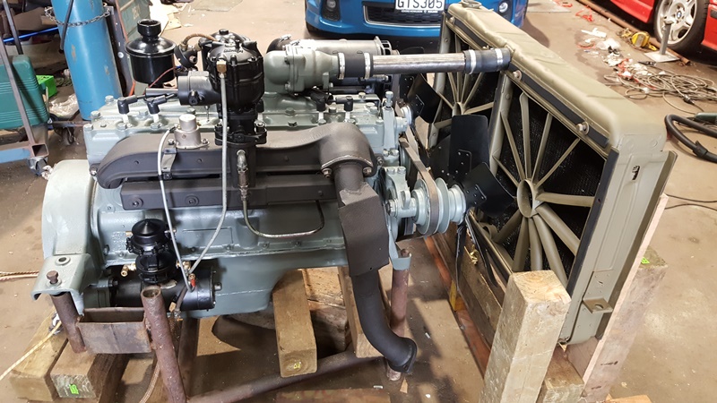

Things are progressing with the engine assembly and my plan is to get this running before it goes into the hull.
I initially had the engine on some wooden blocks but now have it on a stand which we’ll run it on for a test before it goes in the hull. Yes, I know the engine mounts are upside down in the early photos…it was just easier…
I ran out of time to remove some broken manifold studs before I sent the block in for machining so I have now done that. What a pain in the butt job it was removing them. I’ve also drilled and tapped the new holes required at the ends of the block for the longer manifold used on the M8 versus the Scout Car.

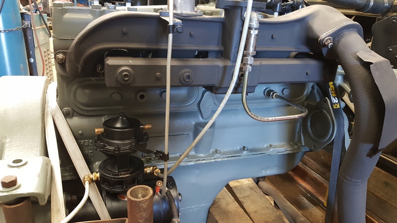

I’ve fitted the water pump, oil filter, fan pulley mounts, coil, manifold and starter motor. I had to fabricate the generator mount stay and the bracket that holds the coil.
I was about to fit the fuel pump I had but realised the mount was wrong. I rebuilt this pump several years ago thinking it was for an M8 and had it stored away until now! I have since been told it is actually for a White halftrack. The correct fuel pump is now on the way to me….
The timing cover on this engine didn’t have a plug in it for blanking off what would be the oil filler hole on the scout car engine. What I did was to use a 1.5” frost plug, clean up the circumference a bit as it was fractionally too big, and tap that into place in the timing cover.
The dipsticks for the M8 and scout car are obviously different in length. Is the length of the handle the only difference? I know the sumps are slightly different but I wondered if it was just the handle being a bit longer for accessibility in the hull.
I have a NOS distributor on the way along with some water pump parts I still need. I actually wasn’t aware until now that the distributor cap for the M8/M20 uses an acorn type connection for the leads. The thread diameter is ¼” UNF. Has anyone seen these connectors commercially available?
I fabricated the small adjustable rod for the automatic choke. I modified the design a bit and included a locknut on the end of each leg to hold them onto the centre piece. I understand the original had grub screws securing the legs. I will need to go back to the forum thread where I got the dimensions and photos for this though to confirm the weight of the rod joining the two legs. I imagine that will have an effect on the operation of the auto choke….
That is all for this week…

This weekend, a friend and I fired up the M8 engine for the first time. Ed is a good engine man and he worked on British Army military vehicles in his younger days. He did most of the internal assembly and set up on the block.
I had completed the assembly of all the accessories on the engine on a tubular steel stand and I set up a wooden platform in front for the radiator so I could run that at the same time and make sure that was working okay as well. I don’t have an original upper radiator pipe so I cut a bit of pipe to temporarily use. This bit of tube is a bit longer than what the parts manual specifies but I needed the extra length so I could give the fans enough clearance from the makeshift radiator platform.
I remote wired the engine into the hull of the M8. I thought this was a good idea initially but upon reflection introducing a whole lot of other variables into the start-up equation was maybe not the best move, when all the wiring in the hull was untested. It worked out alright in the end though.
The first switch on produced nothing and we found the starter solenoid wasn’t engaging. As I learnt on another forum, the M8 is wired as such that when the ignition is switched on, 12 volts is supplied to the control terminal on the starter solenoid. When the starter button is pushed, it grounds that 12 volts which activates the solenoid and sends 12 volts to the starter motor post. I wasn’t completely sure the solenoid I had needed the 12 volts on that post grounded, or needed 12 volts sent to that post, to actually activate the solenoid.
After checking with another M8 expert (thanks Willy) I confirmed the solenoid I had fitted was the correct type. After a bit more tracing I found that the cause of that issue was a bad earth on the instrument panel, so the grounding through the starter button was not taking place. After working through the circuit diagram again I couldn’t see how the instrument panel was actually grounded, as it is mounted on rubber insulating blocks. Anyway, I ran an extra length of wire from the instrument panel body to the panel mounting bracket on the hull. This gave the ground required.
Once I had the 12 volts coming off the solenoid to the starter motor, I found the starter motor wasn’t working. After a look at that I found that one of the brush springs was shorting out against one of the nuts holding the brush pigtails to the starter casing. Those wee springs don’t like high current through them and it damaged the spring. I had to search a bit to find a spring locally but a retired auto electrician I know managed to find one in his box of spares that would do the job. We put it all together and it worked but the nut on the little screw holding the brush pigtail to the case was still very close to the brush springs. I have wrapped the nut with a strip of insulation tape in the meantime but both of us agreed that the nuts are probably not standard. I have a new set of brush springs coming from the US and when I fit those I will find a nut with a lower profile.
I rigged up a fuel supply to the newly built fuel pump and first touch of the starter button on the instrument panel, the engine ran. It sounded very nice and seemed very responsive. The NOS fuel pump which I had put new neoprene diaphragms into worked well.
There were a couple of minor issues during our various tests, like one of the water pipes coming off and spilling water everywhere. I have been advised that I will receive the ‘Golden Screwdriver Award’ for not tightening the screw on the clamp enough. There was also a slight leak in the gasket in the thermostat housing, which I’ll sort out when I actually fit the thermostat.
After a number of starts we found the battery was starting to slow. I did a few voltage checks and it didn’t look like the generator was feeding the battery enough so I will check that and the regulator out.
I have a new calcium type N150 battery but I don’t have a compatible battery charger here and I wasn’t super confident it was being charged fully prior to us starting the engine. It certainly looks like that is the case now so I will order a new calcium compatible battery charger tomorrow.
It’s a great feeling seeing and hearing the engine run and knowing most of what is attached is operating correctly.
I will fit the clutch assembly and gearbox next and then fit the correct ignition lead terminals now that they have arrived (thanks Brian). They need a little ferrule at the end to stop the wire coming out which I have not seen available so but I might have to come up with an alternative for that.
After that, my next step is to fit the newly rebuilt brake hydrovac into the hull and complete all the plumbing on that. I will then pressure bleed the brake system and that should get the hull pretty much prepared for fitting the engine and gearbox assembly.
