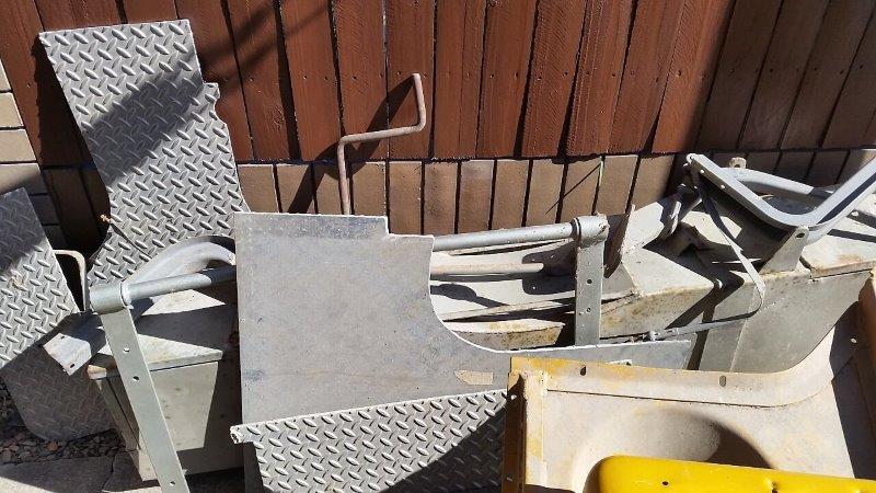

Default Initial pictures of parts
Starting to identify all the parts of my new project.
20170730_103544sml.jpg   20170730_103559sml.jpg   20170730_103630sml.jpg   20170730_103645sml.jpg

Default Images of my restoration
Bringing home the project and the parts included.
20170729_183955.jpg   20170729_184004.jpg   20170730_085735.jpg   20170730_103544.jpg   20170730_103546.jpg
