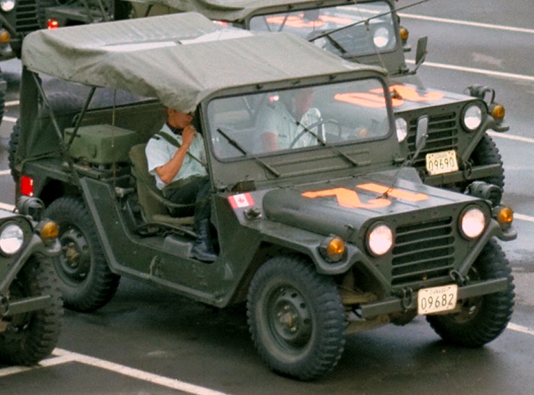

Hello
There were at one point in time canvas radio covers. Attached is a photo of vehicles at the Montreal Olympics in 1976. Maybe once they were lost or damaged they were not replaced.
Eric
