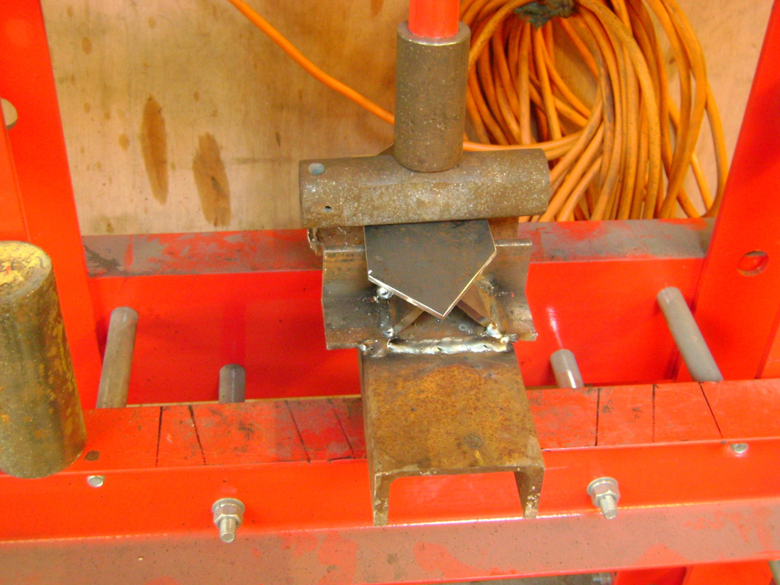

I have at last, managed to fabricate the suspension arm travel stops / bump stops and attached them to the chassis. It seemed to take ages to complete these items but we have been in a perma frost for a week, that seemed like a month, snowed in and the workshop was frozen up, thats my excuse anyway. They are not perfect but as near as I could get them, the grey one is from the Bovington tank museums PZ2.
For my next trick I am going to make the track return rollers, now that will be fun.

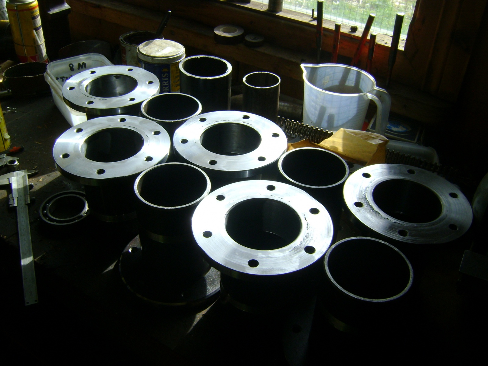

Morning all,
I now have 10 complete wheels ready to have their polyurethane tyres cast on, 10 oil seal housings and 10 end caps. I am currently machining the shafts that connect the radius arms to the wheels so hopefully by the end of the week I will have 10 finished radius arms as well.

Posts: 535
Evening All,
I have made a start on the track idler wheels, the initial piece of 180mm dia solid, has been following me around for the last 16 years, many times I have been tempted to scrap it but I could never quite bring myself to do it. It has survived a divorce, I have tripped over it, stumped my toes on it and used it for no end of things but at last it's true purpose has been revealed. How it gets from this bearing house, to the idler wheel requires a lot of work, a cunning plan and some imagination

Posts: 535
Evening All, again,
I haven't got a big press or indeed any of the tooling required to produce the cone needed for the idler wheel so I decided to make it in 8 individual pieces. I used what I could find a real bodge it and scarper set up but it worked. I used a very old and hard as nails piece of oak, that I planned to the form that I required, as a press form tool. What can I add, I use what I have and none of it is modern or complicated. I am doing quite a bit of machining as I go along to make sure that it all runs as true as possible, so its taking a bit of time.
