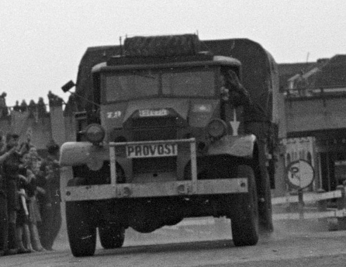

Another subject of interest to C8 owners....early C8's had only one set of Rubbolite lamps at the rear...while later ones had lights both left and right.
Source: https://upload.wikimedia.org/wikiped...-45_B13120.jpg

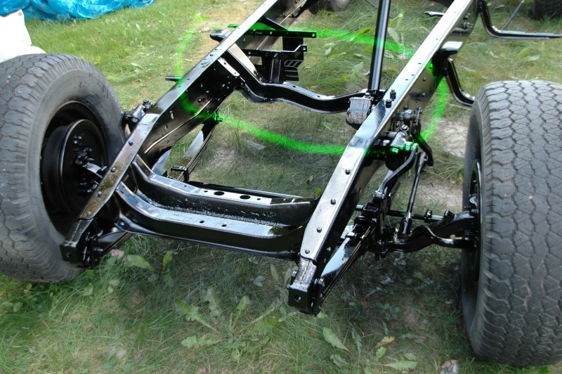

HI Richard
I acquired a 1937 Chev one ton pickup frame a while back ....some interesting comparison can be made.....
The front picture shows which cross member I am talking about....
The second from the rear.... I have outline what I think is the same frame cross member from your picture.......... can you tell me how similar the rear spring hangers appear to your eye....? how about the front axle/frame set up.
The 37 Chev 1/2 ton pickup had a similar curved frame over the rear axle like a C8 but the one or 1 1/2 ton Chev had a flat rear frame.
I really need to take more close up of that frame from various angle for further comparison.
I always though it would be possible to mock up an early pilot CMP model using that frame.......
1937 chev 1.5 ton frame on kijiji.jpg   $(KGrHqF,!rMFDILqhLbPBQ8dCw!lew~~48_20.jpg
