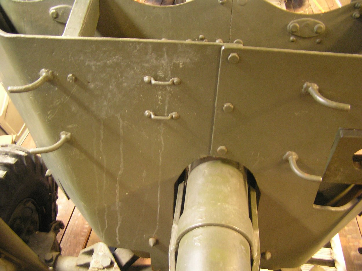

The image below is the firepower museums 6 pdr. The drag ropes fitted look like early style light ropes with the leather lined eyes.
The stowage hooks for the rope look to have less than 2 yards circumference and there are probably about 6 or so loops of rope wound on.
Two ropes of 15 feet each are 2 x 5 yards = 10 yards
Can anyone measure the diameter of the hooks on the shield to compare with the diameter of the ropes please?
Alternatively can someone wind a 25 pdr rope on the hooks to see whether 30 foot of 1 inch dia rope will fit?

Rob, as I said in the other thread, 6 pdrs can have two lengths of rope hooks. The shorter ones are not long enough to take a 25pdr rope, hence the reason I started that thread.
Most guns seem to have the shorter hooks as do the later auxiliary shields. I suspect the no2 ropes were 30' long in 2" rope (5/8" dia.).

My thoughts are that the longer rope stowage hooks on a 6 pdr shield would suit the thicker rope, but not at the full length of 30' for two thick ropes. Has Marc's gun got the short or long hooks? One long rope = 2 short ropes
Rob Love's scans of the 6pdr gun manual does show the 2" rope and indeterminate length. What is the difference in weights for the two guns?
The longer a rope is, and the more soldiers pulling on it, the greater the load on the rope at the gun end. From a strength point of view, there doesn't seem any advantage in the heavier rope if it is shorter. Perhaps it is easier to grip by hand?
Like wise the lighter rope may not be strong enough for 30' of soldiers pulling as 2" rope has only 44% of the cross sectional area of a 3" rope.
The pics on the Armorama site show different lengths of rope although one look to be broken. So maybe there is an intermediate size between 15' and 30'?
Regarding the chains at the other end, although the rim of a 25 pdr has a greater diameter, the tyres have similar circumferences for 9" versus 8.25" dia. The drawings in Rob's scan show 8 links on each chain for the 6 pdr, but the Aussie rope in Euan's pic has 11 links.
It would be useful to try the different lengths and sizes of ropes on the hooks and post pics here for comparison.

I carried out these checks this morning.
Firstly, a standard 25 pdr rope on a pair of the short hooks on my gun. Incidentally, one of the other guns I have here has slightly shorter hooks but they are both considerably shorter than the long ones seen in some period pictures.
Whilst it is possible to fit the rope, it does not leave enough room to fit another on the second pair of hooks. The longer hooks seem able to take a 3" rope.

I believe that the 30' of 2" rope is correct, it best matches period pictures that clearly show a rope that is the smaller diameter. It also seems to show hooks that are smaller than the 25 pdr hook and rings of a smaller section.
I tried a 25 pdr hook in a 6 pdr drag washer and it was a very tight fit, the 25 pdr drag washers being considerably larger.
Therefore, I believe the No2 ropes were made from a 30' rope of 2" circumference with a smaller hook on one end and chains and rings to suit the 8.25-10 wheel.
There is a famous picture of a crew coiling 3" ropes on a 6 pdr but that also has the very long hooks. They are noticeably chunkier than the ropes in other pictures.
If we can find a known original rope however, I am quite prepared to be proven wrong!
