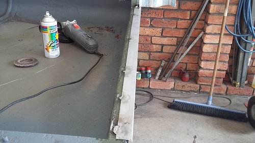

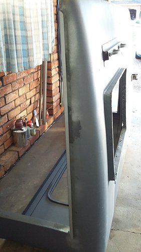

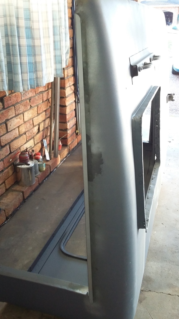

Well have chopped off one gutter, and cleaned up the seams as well as treated the rust as good as I can, welded up the rust holes.
Now tomorrow I will weld on the new gutters, sadly I miss measured the box section so I will have to get another couple of U sections folded up to make it all look original.
There's always plenty to do . Colonel Klink and the cat think its great!
Photos for observation,

Hi Folks,
After last week's eye injury (grinding grit in my eye- and I was wearing safety glasses) Managed to finish off the drip rails with a re-made piece of the correct dimensions. The box section was too small so a new drawing and off to the sheet metal man again.
This is markedly better than the rusted ones of 70+ years.
Its very satisfying to see parts how they should look, not old and damaged.
I dressed all of the repairs to the roof again, not satisfied with the first pass. About 6 hours work now but the result is great.
Ahh and you can see I have to repair the hatch area (Ford) when has a lot of water damage over the years. Again, my measurements were a little short so I will have a rail made at the sheet metal shop.
Ian
