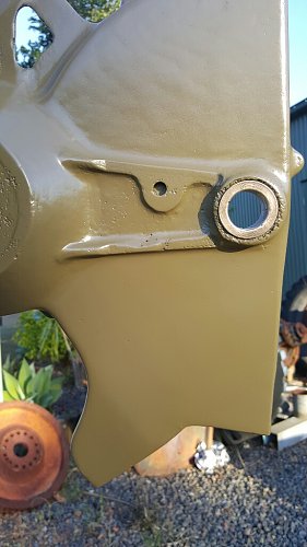

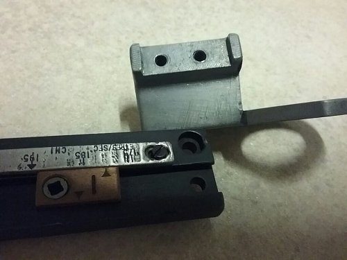

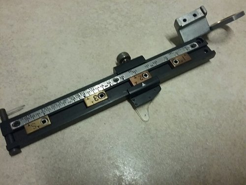

Old 08-01-17, 12:22

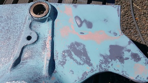

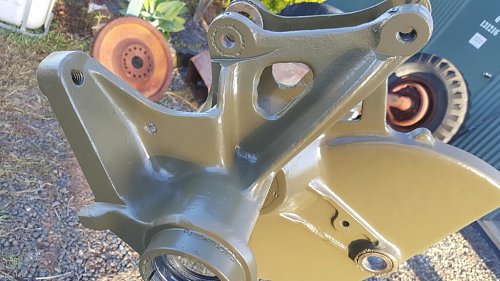

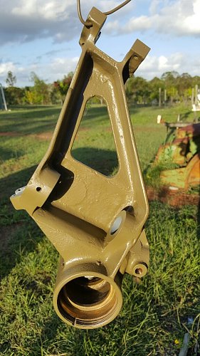

To add to last couple of posts, regarding use of aluminium in sight carrier parts. Once all the mechanical parts and the large brass part are all off the sight carrier frame, it became VERY light. You guessed it, it's aluminium also, and today all the paint was stripped off. That is a job I don't want to do again. It took hours to get almost every bit of paint off, followed by a thorough wash down and quick scrub with the wire cup on places I could get to.
Have a close look at the above photo. Any exposed point where two dissimilar metals touch, has evidence of significant corrosion of the aluminium. This occurs, regardless of the 'other' metal type. IE: It occurs where Aluminium touches mild steel, brass, or bronze. This does NOT seem to be as significant an issue where Aluminium touches aluminium, but it has suffered to a lesser degree. I mention all this merely as a point of curiosity. It won't affect me, beyond need to apply some filler here & there. Also interesting, when running the wire cup over the surfaces, small flames could be struck between the two! Not sparks......flame, up to about 3/4" in length, and these did not fly off as sparks do. Must say I don't really think I've put an abrasive cup on aluminium before, but I have cut the stuff with a disk and shaped using a grinder disk, and I have not seen this phenomenon in the past.
ID:	87780 Click image for larger version

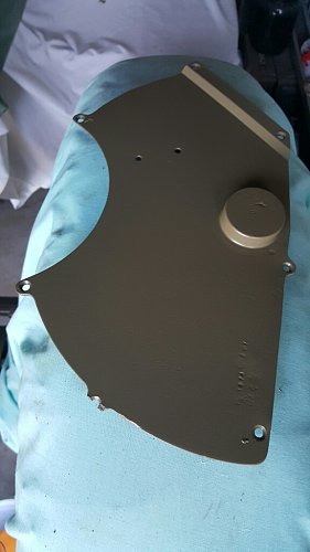

Some parts got their final coat.

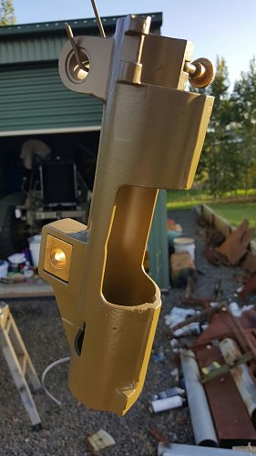

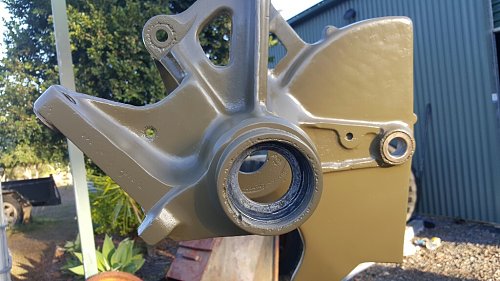

Others got a thorough clean, and are now ready to be put in place, once the final little pieces have been acquired. For example, I still need a pair of small brackets for centre of the cross-levelling screw assembly.

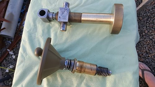

I'm also having difficulty in locating the correct size/TPI nut that holds the range indicator handwheel, in the above image. Local hardware retailer now stocks only metric nuts & bolts. Bunnings has a better range, and does have imperial sizes, BUT not all types of imperial threads. They certainly don't have the one I want. I've got some TPI and thread width gauges laying around somewhere.

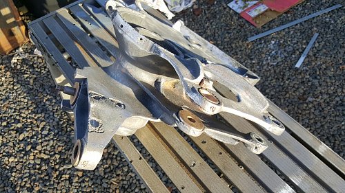

That's really beginning to worry me, guys. Magnesium would mean I could do a far lesser quality repair to the corroded bit. I will snap off a small piece of corrosion and take it across the road to my welders place for testing. I tried a small chunk myself, using my propane torch, and it didn't react in any way, but I know from experience that it would probably need more heat than i could subject it to, before 'flame on'. Anyone ever throw an old VW gearbox case into a bonfire? Wear sunglasses if you ever plan to, and be prepared to wait a while for the reaction to start.
When there was still decent hope it MIGHT have been aluminium, I was doing some mental planning on exactly HOW the repair could be fashioned best, and decided I would require purchase of some plain sheet aluminium to craft the new sections. The only place I know of in town that could easily supply me a small piece, has now closed down, and i was lamenting their passing and cursing my lack of luck with regards to the effort now needed to scunge just a small bit of aluminium plate. While puzzling over where to start looking, I suddenly realised that while I was sitting there cleaning parts, I was in fact directly facing a far larger piece of plain 6mm aluminium plate than I could ever expect to need. It was leftover from making my shield, and I had resisted throwing it out some time ago. With any luck, my metalworker/welder neighbour can bend 6mm on his enormous metal folder, and I will use that to fill the area left vacant by the corrosion. If the original item IS magnesium, I have a plan that should see a nice piece of aluminium grafted into place without requiring any welding.
  #219

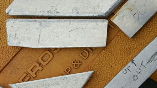

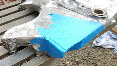

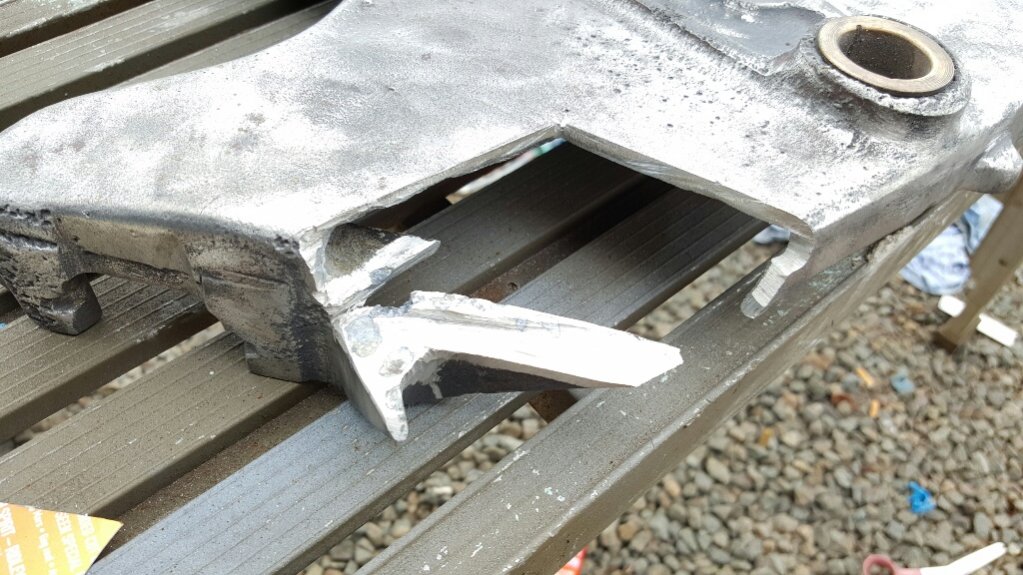

Old 22-01-17, 08:47

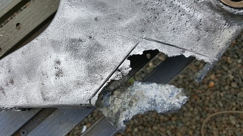

No David, not load bearing, but whatever I graft on will need to be 100% fixed permanently in place, or cracks will eventually show around the edges. I did consider doing that, but using fibreglass. This morning I made all the sections to repair the hole once and for all.......hopefully!
I'm almost sure this thing isn't aluminium now. Seems lighter than aluminium, and it files differently. My welder friend isn't home today, so I never got the definitive diagnosis. Will watch for him tomorrow.
I didn't set anything on fire while cutting the rot away, and was VERY careful I did not put too much heat in one place. When all corrosion was cut away, I was left with quite a hole.

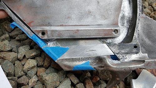

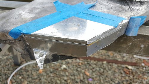

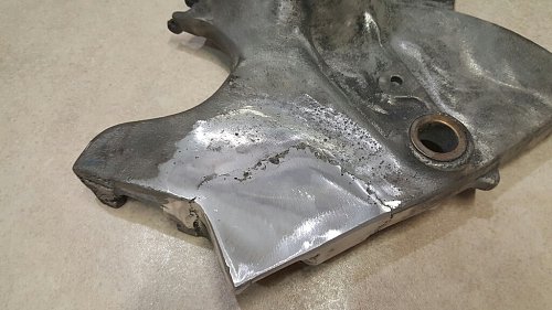

There are 6 separate pieces making the repair patch.
I taped them all together to see what the profile will look like. While it's not exactly original, it will do.
More details in the next posting....

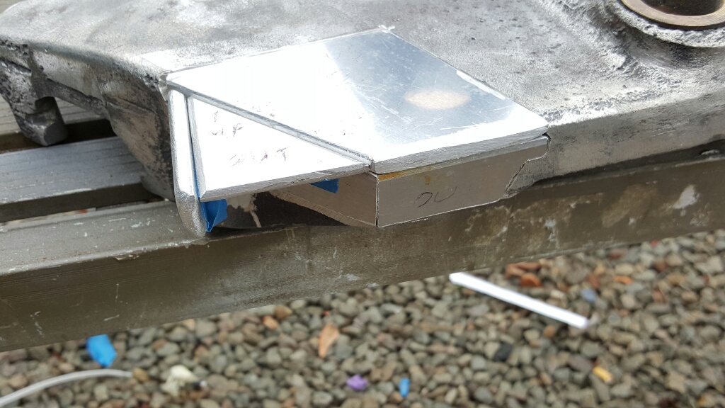

  #221
Old 22-01-17, 09:18
Once all the aluminium repair sections are welded together, I will attach the entire thing as one piece. I'm not sure of method to keep this in place, but am considering construction glue and having a plate welded against inside of the repair patch, overlapping the inside edge of the original by at least 1". The metal of both items is thick enough for me to drill and tap the few holes for better fixing. I will need to be careful not to go too high with anything on the inside, because there is a gear toothed sector that adjusts up & down in there. If done carefully, I should be OK.

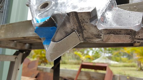

The new pieces sit better than they look in my photos. They're only held in reasonable proximity, with a few bits of masking tape.
The below photo shows the only piece that won't be seen, but it's important. This piece needs to help secure the large cover panel you can see sitting above it, and one hole will be required for a fixing bolt to keep the cover in place. That bolt will also help keep my repair in place. I should have no problem keeping the new bit in place, once all methods of fixing are used.
All these bits go together to fix one rust out!

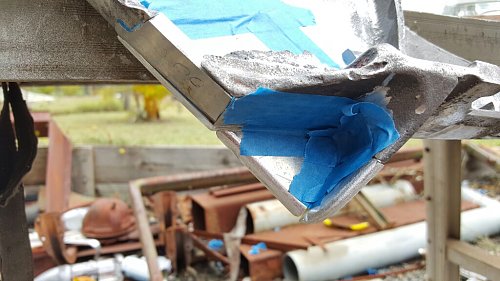

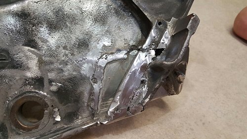

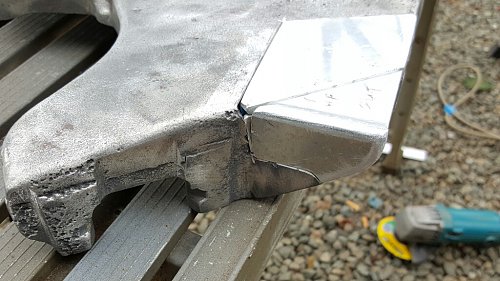

It took me a week, but I've just had the opportunity to discuss my welding requirements with the pro welder neighbour. He has been away in western Queensland for the past 8 days. I figured he was away. Hadn't seen his vehicle all week, and have been chomping at the bit to get his thoughts on my sight carrier repair patches. The outcome is encouraging. It would appear that the original section is indeed magnesium alloy. Potentially problematic to weld, but he is confident, and fully appreciates the peculiarities & unique properties of working with such an unusual metal. The welding should get done through the coming week, and I expect to have the finished product back with me by next weekend. There's nothing like having professional assistance with a tricky job like this!
All going well, I hope to be applying the minimal amount of filler needed to entirely disguise the grafted in repair section. Should have filing, filling, sanding, and priming done during, or ideally by next Sunday. If still enough daylight left after all that, I may even get color on. If so, reassembly may commence by Monday evening. That will be exciting, and will give me the first opportunity to see the parts working together again as one unit.

It's not finished yet. My welder mate had extreme difficulty with the welding, and as a result of the porous original magnesium and new repair of aluminium being different metals with different cooling rates, he wants me to add additional strength holding both together. He suggested I fill the inside of the repair with fibreglass, and overlap beyond the line of weld. We think about an inch and half would be plenty. He also suggested I buy Liquid Aluminium to fill welding imperfections. I'm having a look for that online now. If I can locate something suitable locally, I'll get into that job tomorrow afternoon.
My fellow had a hard time working this piece, and he's a professional welder who owned a large engineering works. If it gave him grey hairs, imagine what it would have done to me! I'm ever so grateful for what he has achieved. The next step is up to me now.

Nice progress! Because both of these metals oxidize very quickly at first I would recommend bead blasting the area and coating it right away with some kind of epoxy (JB Weld, Araldite, Devcon etc., not sure what's available down there) to make sure there is no oxidation in the porous areas.
