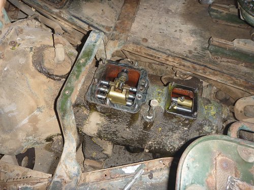

Default Assorted pics
Manual
Name:	Colin's truck.jpg
Son's Diamond T
Cabin

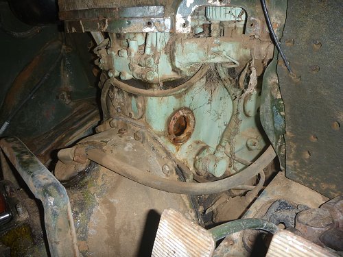

Gearbox

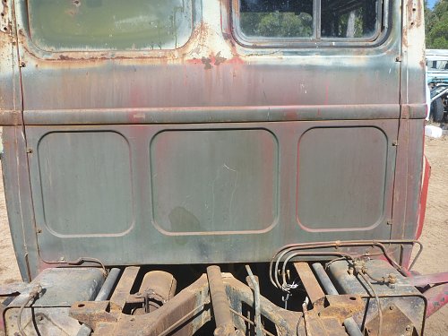

Rear core/welch/cover was corroded, made a new one

It never ceases to amaze me how after 60 yrs or so grease mixed with a bit of dirt etc turns in to a form of sticky-hard-concrete that is only removable by scraping and scrubbing for hrs,i spent most of a hot 37 degree celsius saturday just cleaning the engine which wasnt disgusting but where acummulated heavy deposits had been left for decades refused to shift easily.
Same with g/box oil/grease had melted in to a sort of smooth/glazed layer on outside of casing.
john

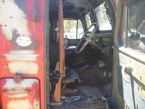

Had a quick look at the rifle brkt upper, divers side. It is longer than the pass. side, and runs towards the rear, with the rifle leaning back at an angle to help in egress/exit. The pass. side is shorter due to the mounting of the spare wheel.
The water jacket cover's are prone to corrosion, well spotted. There are three of them and are probably all worth replacing. I have ,made them out of Stainless and Brass.
The rectangular cover block on the back of the head, ditto.
The block with all the pipes on the back of the block ditto. These are breather pipes for dissy etc. and no doubt full of crud. The blocks are available NOS.
Wait till it hits 45, all the grease will run out, hey presto, job done!

Thanks Rich never thought of waiting till it hits 100f good idea.
will be checking other water jacket covers now you have shown me your ones for sure.

the rifle pic, i have tried standing with magazine forward and facing backwards hadnt quite worked out which way it would have stood i thought most prob the other way to one pictured would be it. cheers

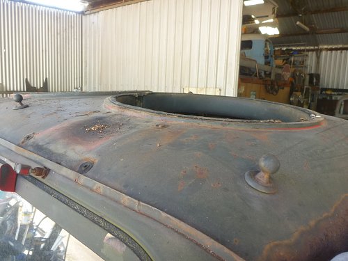

Removed tub to get at everything eventually, but concentrating on roof rust at moment so dont want grinding grit every where it doesnt have to be.

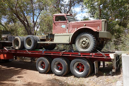

Just as an aside to Humber movements this shows the lengths of travel some service vehicles saw,the ex RNZIR 66 kiwi land rover i have which is closer to british MOD ones spec wise than Aussie landys, went to NZ then shipped to singapore and may have seen vietnam service was imported to Perth in a batch of landys and bedford RLs may be 20 or more vehicles in mid 80s for auction here instead of returning to NZ, so army type decisions can be a bit puzzling in any country,unless they WERE sold off in Singapore and then imported by a private concern.
I saw 6 or 7 of the landrovers some were rotten as a chop chassis wise others were near perfect all with low mileages ,some made it on to WA roads but havent seen any recently,the sole Bedford i saw was very nice all hood bows and canvas present went to a collector i know not where,there is a bit of a write up on REMLR re the auction and numbers but i cant remember it clearly.

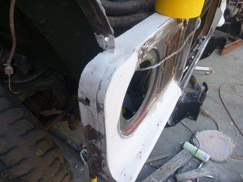

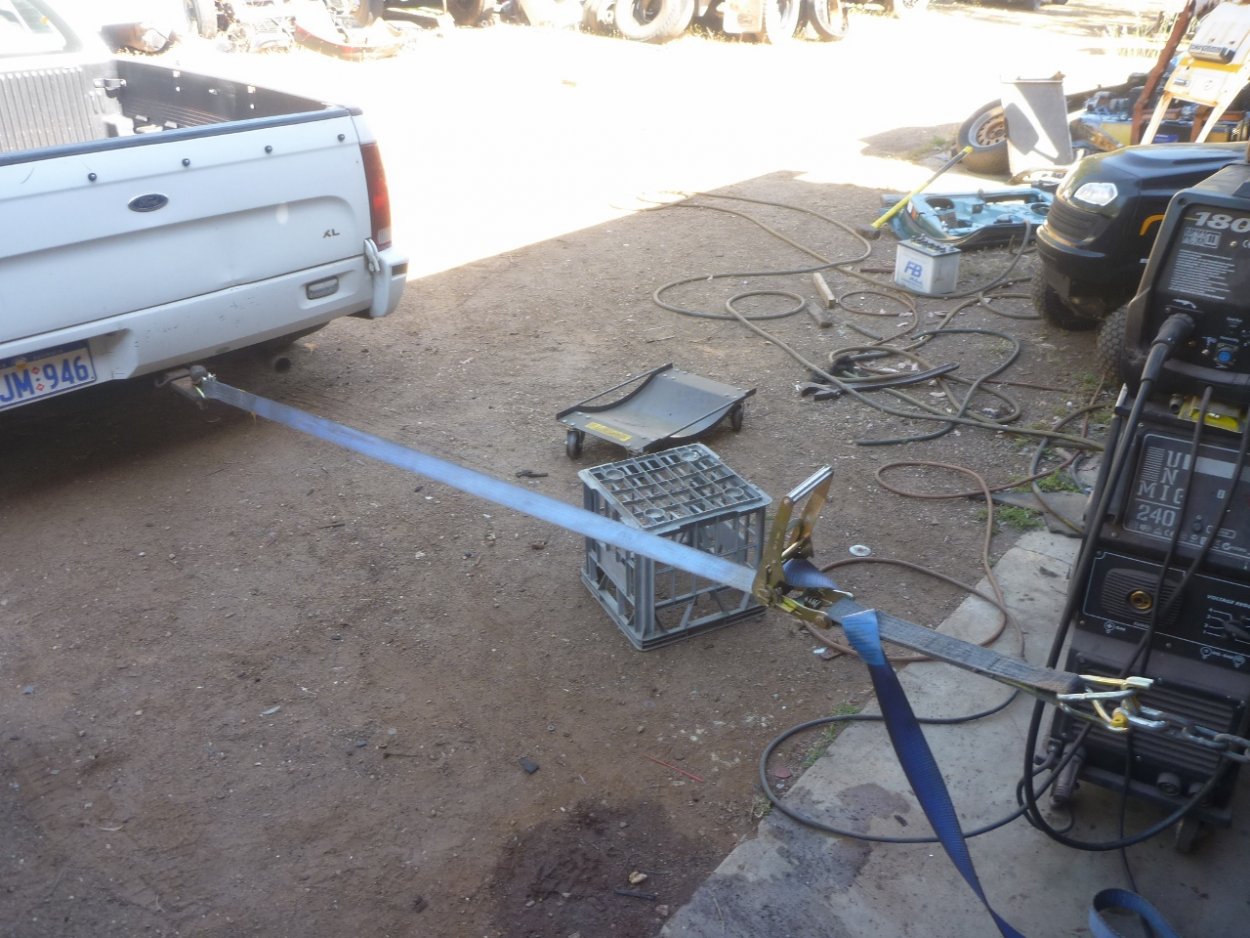

Name:	P1120680 (1280x960).jpg

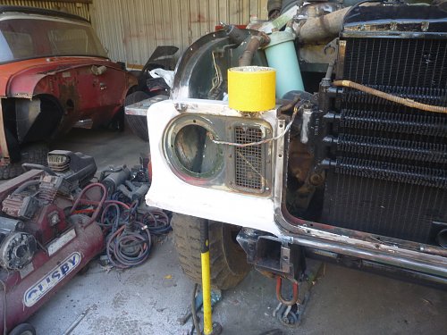

starting to pull panel back in to shape
Name:	P1120683 (1280x960).jpg
second point of attachment
Name:	P1120682 (1280x960).jpg
use what ya got
this and next pic 3/4 finished

grille stripped ready for etch prime

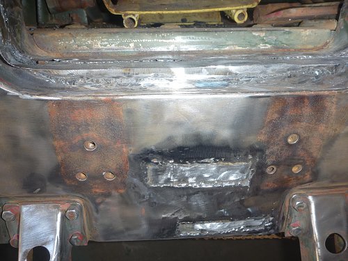

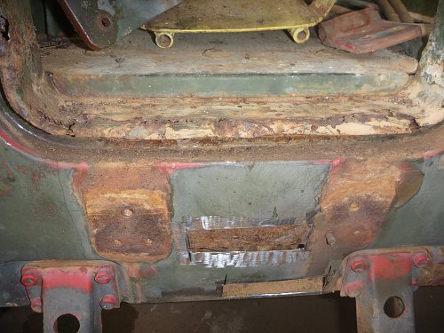

rust area at bottom of spare tyre hatch opening
painted straightened grille(not that it was badly out of shape anyway)
new metal sections welded in

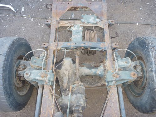

Thanks Rich,i just thought torsion bar settings were off until i realised LHF tyre was an 8.25,i will be leaving tyre selection till very last.
i see a lot of people race out and buy new tyres first off on a lot of car restos but you know what its like ,time drags,priorities change,loss of interest yada yada and then you have a car still needing full rebuild with brand new buggered tyres(radial cracking etc).

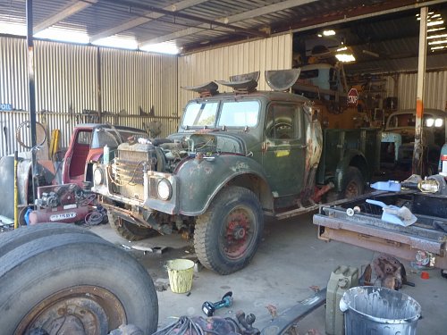

tub off,rubbing down on door looking for any old unit markings
rear of chassis reasonable cond really
roof with LMG 'rail'? mounts
lower back of cab is pretty well spotless for no rust

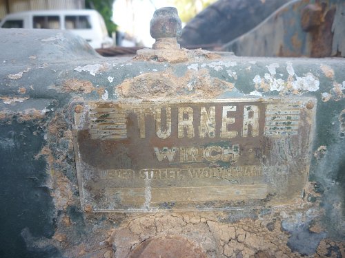

rear winch plate---- finally checked eng no and it is the orig no

Yes, the mounts on the pass. side roof were for a LMG mounting rail (always remind me of Great Gazoo, off the Flintstones, for some reason.) You will have noticed the non slip seat base for the hobnailed boots....
