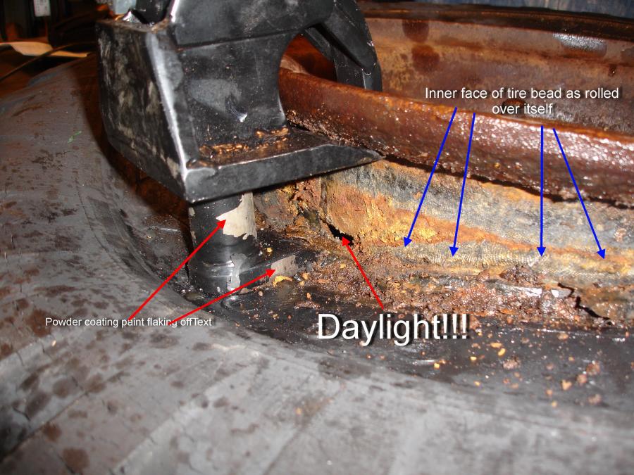

After repositioning a few times we started to see the inner edge of the rim..... this is after 4 separete tries.

We had to use the tool to fully rip the rim out of the tire.

Just has difficult to insert as on the front side except now we now how to approach it.....tap tap tighten..... the back half is much deeper and almost requires to go around at least 3/4 of the rim ......block off with wooden block then come back to push it down evenly. The foot is long enough to unrim the tire.

Eventually the tire gives up and the rim comes out......
Yes it takes arm muscles....... and on a real tough nut like this one and being the first we did about an hour....... it took melonger to edit, resize and post the information.....

Bottom line ..... on some really badly rusted rim/tire it maybe wiser to resort to the various proven "cutting methods" used by members OR spend the big bucks for the professional hydraulic models or visit your local truck centre and pay the man.
Meanwhile we are going to rebuild our model to be more resistant to our heavy handed approach and keep the worst tires for the chainsaw and chisel.
The Barn Boys
DSC02363drwrez.jpg   DSC02364cttxtrezrs.jpg   DSC02365textrez.jpg   DSC02368arrtextrelast.jpg   DSC02369textarrrz.jpg
