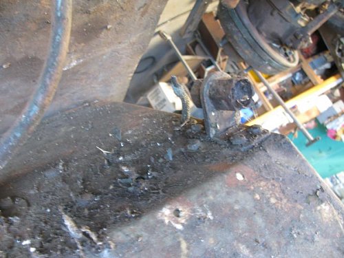

  #61
Old 26-06-15, 12:39

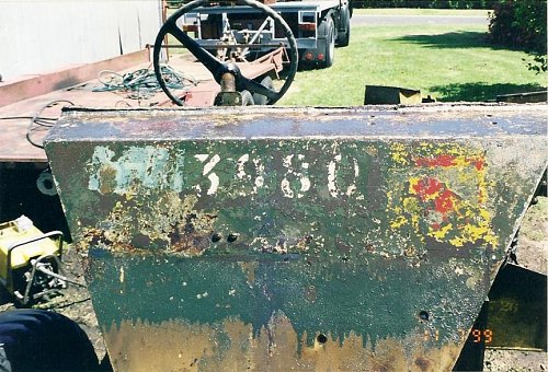

Some old photos from 14 years or more ago when we started to weld the armoured windscreen into place. The rear armour was also taking shape.
This is what we brought home taken from the front showing the Australian ARN. 123980.
The mounting bracket for the steering column helped to locate the exact position of the front armour.
The column mount bolts to both the hull and the 1 inch + ¼ thick armoured ‘windscreen’ panel. This was to help locate that windscreen panel in its correct place when we welded it back on.
Now back to stripping the hull 2013. The steering column was again removed from the hull and put aside for later work. The steering wheel was extremely hard to turn and the column had to be completely disassembled and new bushes fitted.

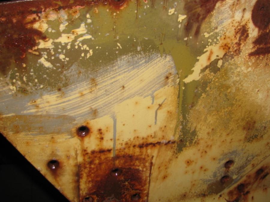

The hull was now nearly ready to take to the sandblasters but before I took into town I did a complete photo walk around taking photos of every stencil and sign on the hull, mudguards and lockers etc.
The Hull number 1726 was stenciled onto the front of the fuel tank armour on both sides. Note the sand coloured base paint with green camouflage.

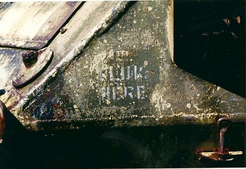

‘Sling Here’ at the four lifting points.

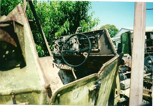

‘W/T’ on both escape hatches. Notice I did not say doors, these are just that, Escape Hatches in case of a roll-over.

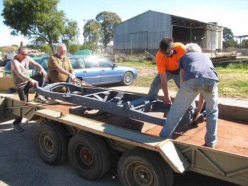

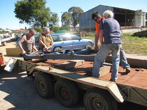

The chassis was ready to pick up from the sandblasters and with that out of the way I was able to take in the stripped hull, the front axle complete with springs and other smaller items.
Name:	Lynx SandblastHull 123.jpg
Once again a crew at the sandblasters was arranged and they did the heavy work as I took photos.
Name:	Lynx SandblastHull 124.jpg
The chassis came up a treat.
Name:	Lynx SandblastHull 125.jpg
At last I was starting to see some results happening. The chassis was taken home and set up ready to receive the many items as they were rebuilt.

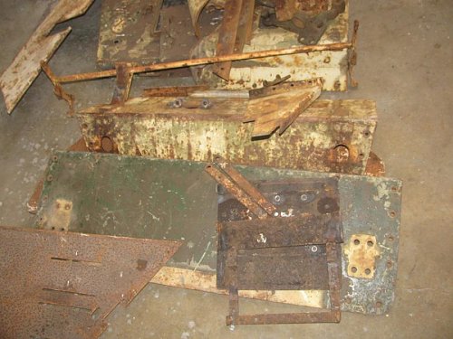

  #64
Old 27-06-15, 14:01

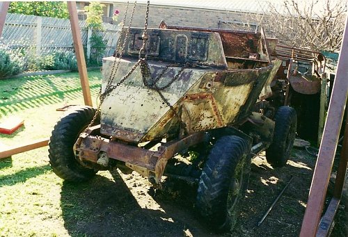

Well believe it or not we were only 21 days (three weeks) after the Lynx was pushed into the shed and the chassis has been sandblasted and painted in undercoat.
Name:	lynx 31 05 019.jpg
You do not realize how many parts there are until you completely strip a vehicle down.
Name:	lynx 31 05 024.jpg
Many more small pieces were then taken to the sandblaster.
Name:	lynx 31 05 022.jpg

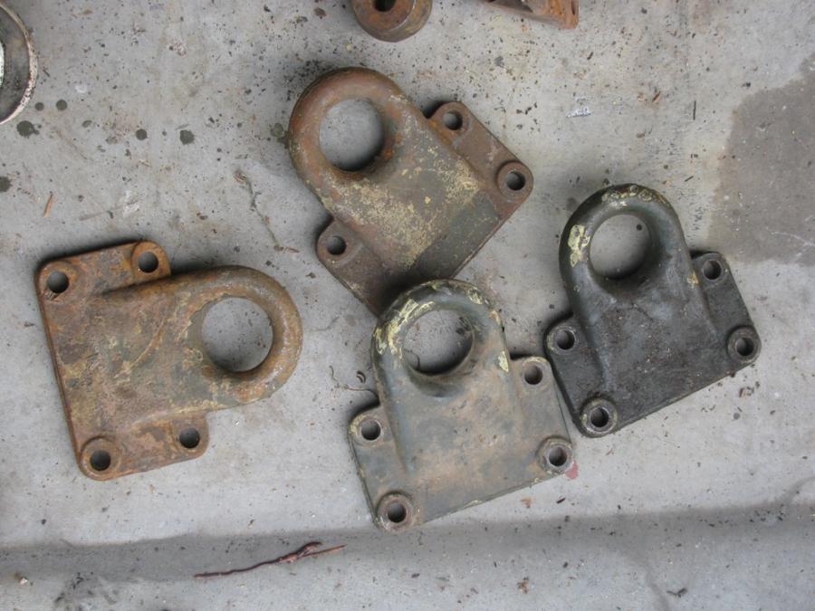

The rear radiator armour is one heavy piece but I was glad that it had not been butchered as it lay out in the paddock for 40 years.
Name:	lynx 31 05 021.jpg
ID:	74721 Click image for larger version
Name:	lynx 31 05 004.jpg
The lifting rings. And there is a story. The hull had the two top rings with it when I picked it up so I had to locate two more. Tony L. in SA found one for me and I was able to find one in a farmers shed. This farmer had wrecked a Lynx many many years ago (Hull No. 718). He thankfully still had the drivers seat and a few small bits. I visited him one day and as we chatted in his workshop I saw one lifting ring hanging on a nail on a post. That gave me the four I needed.
I did know where the two original ones were off my hull. Charlie McCallum had welded the into a rear bumper bar on one of his Dodge Weapons Carriers as tow or tie-down rings. This Dodge is now in the Canberra area and I was offered the bumper bar but the rings had been well welded in.
Rick

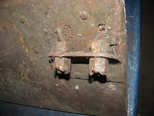

  #65
Old 29-06-15, 12:19
There were still plenty of bits to go on with whilst waiting for the sandblaster to get his gear repaired.

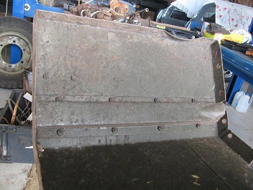

The armoured roof was next to be dis-assembled. This is quite a heavy bit of ¼” armour plate which hinges in the middle and then folds back out of the way.
Pulling this handle releases the two latches at each side to allow the whole thing to lift back.

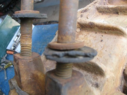

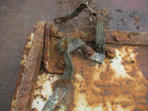

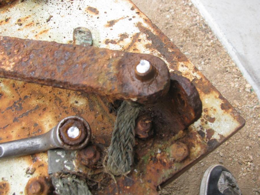

There are hinges, latches, pivot arms and plenty of other fittings including the earthing straps every where.
Not all the nuts came undone, but I was pretty lucky.

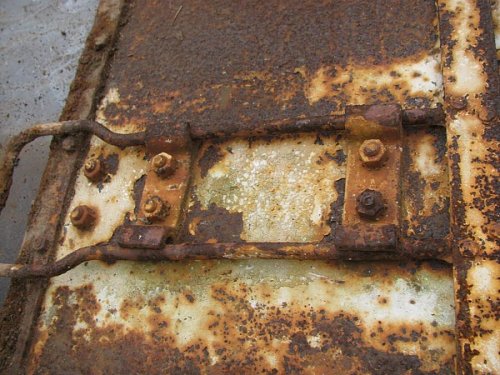

The latches were rusted solid and I had to get new springs made after pulling the whole thing apart.

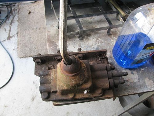

  #66
Old 29-06-15, 12:37
The reason it hinges in the middle is so the front half can be folded back or with it in that position the whole roof lifts back and sits on a special rack at the rear of the crew compartment. Rubber head protectors were where the darker parts are. These pads were about 1/2 inch thick but very necessary when closed down.
Plenty of rust to beat here.
The Lynx Mk.II did away with the roof and partially closed in the top opening with rubber pads all around for protection. (Peter Duggan has that type).
This is one from the web. You can see the rubber pads around the opening.
On the Lynx Mk.I special locks are supposed to hold it in the open position otherwise you might be decapitated.
Rick

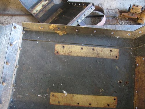

Old 01-07-15, 09:47

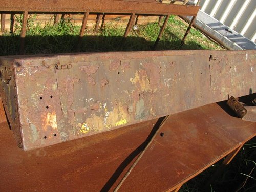

Not all the metal in a Lynx is armour plate. There are the mud guards, lockers, many brackets, the under engine belly plates and the radiator grill, and a few other thin bits.
I was lucky as when I located the hull at Charlies, the side lockers and mudguards were almost undamaged as you can see in these two photos.
ID:	74772 Click image for larger version
The full width front locker was still attached but had seen better days.
The mudguards were basically straight but would take quite a bit of panel beating to make them good enough.
No, that is not a dent or bend in this left side rear mudguard. It is the factory made clearance for the muffler which is seen on both the left and right guards.
Rick.

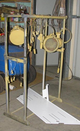

The diamond pattern mesh grill only was slightly damaged and not beyond repair even though it was lying out side for so long. This grill is the same open diamonds shaped extrusion as a Chev Blitz radiator grill. Strange as it is a Ford product not a Chev. I will put up some photos of the grill in the next post.
I had placed all of these thin bits under cover back when I first picked up the Lynx and had not been near them since.
I was very fortunate that whenever Charlie pulled something to bits, he put the nut and washer back on the bolt and threw them into a tin. Every bracket had the bolts put back into the holes in the bracket with the nuts and washers. Who does that? I might with some things, but Charlie was regimented in it. Most of these bits were scattered through-out the auction and as I said earlier, I was able to locate most of them, place them on one pallet and purchase then as a job lot.
The front and rear guards still had their light brackets but the light were beyond saving. More on the lights later.
The front guards still had the head light brackets which had been highly modified, the side marker lights which were rusted out and none of the locating brackets or footman loops for the 2 gallon cans which mount on the guards.
The guards needed a good clean before being straightened and taken to the sandblasters.
Rick.

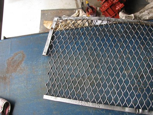

Old 02-07-15, 11:29

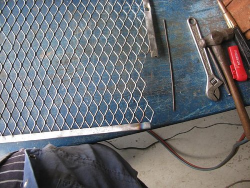

Found some photos of the grill after it had spent quite a long time in the molasses tank and after pressure washing and wire brushing. You can see how well the molasses tank works.
Name:	Warragul Rally 004.jpg
The top corner was quite bad and required quite a bit of work.
Name:	Warragul Rally 002.jpg
I then started to repair it by welding new bits into the grill where they had been damaged or cut out.
Name:	Warragul Rally 003.jpg
The grill has a folder edge around it and this had been cut and was also missing in parts, so it was a case of bending up a replacement and welding it into place.
Name:	Warragul Rally 001.jpg
The mesh section is like flattened wire. I found some fencing wire the right size and proceeded to flatten it with a hammer on an anvil. I was really surprise how many inches I had to flatten to repair the whole grill. The mesh goes into the edging all the way to the inside of the bend, so as you can see there was quite a bit to add in places. I bent each length of wire into a wavy section the same shape as the mesh and used the oxy-acetylene to weld them as needed.
Name:	Warragul Rally 005.jpg
Rick.

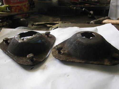

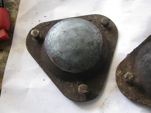

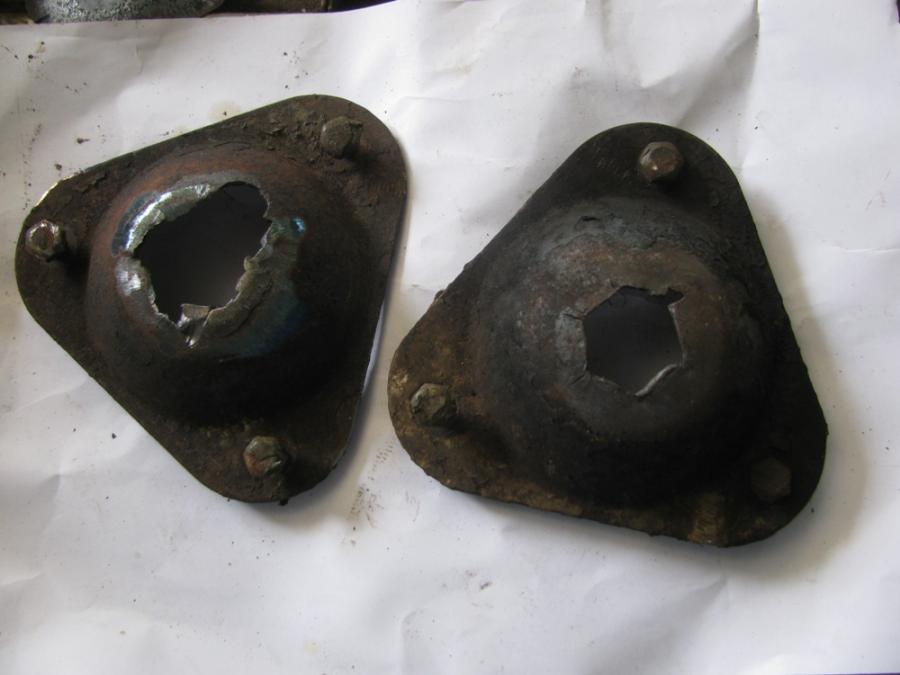

I was still held up with the sandblaster so I decided to do some of the smaller items which needed repairing.
Name:	Benambra Display 062.jpg
The headlight mounds had seen better days.
Name:	Benambra Display 059.jpg

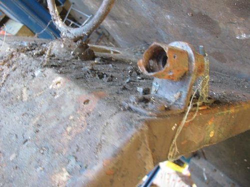

These mounts are Lynx specific only, not made to fit anything else. These had been modified to accept some sort of fork mounted light.
Like those you see on a veteran car. (These are on my 1914 Talbot Type 4CB.)
Name:	Benambra Display 063.jpg

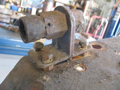

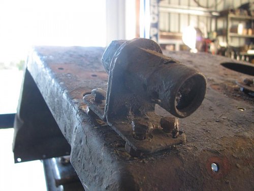

The fork mount had been crudely welded into the Lynx mounts. The forks were removed and work started on the repairs.
Rick.

The Lynx head lights are the same as those found on a Cab11 or Cab12 Blitz and tighten up by a single nut from under the mount.
Name:	Benambra Display 061.jpg
I was lucky that one of the mounts still had it's basic shape and was not too badly mis-shapen.
The other one????
I formed a bowl shaped piece with the same sized convex shape as the good (?) one and I welded into position.
Name:	Benambra Display 064.jpg
cleaned it up and then cut the six sided hole in the top
a small amount of filler and there they were finished.
Rick.

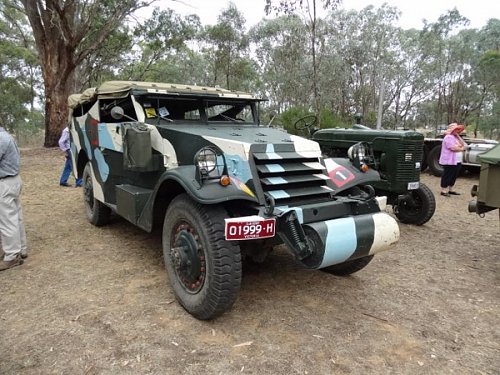

In 2006 at the Bellfield Melbourne Tank Museum sale there was an M3A1 White Scout Car with a quite unusual camouflage style. Painted in a three colour pattern the blue was something I had not ever come across before in Australia. I mechanically restored this one for the owner (a big big job) but he wanted to retain the unusual cammo as it was.
There are many photos of vehicles belonging to the Long Range Desert Group during WWII and some restored or look-a likes with a blue cammo scheme.
BUT I did not think that I would find that my Lynx also had Blue cammo.
Blue paint under other colours so it has been there a long time on the rear left engine bay side.
Splashed over the hull in many places was the remains of blue cammo. It was to be seen on the rear engine bay sides, the hull, lockers and mudguards. This was in places over painted with green. I say splashed as there were plenty of runs as well as rough brushings. These runs were behind the left locker attached to the left rear guard. The blue went across the locker lid and down the outside.
Rear of the hull near the right side lifting ring, with the runs going down behind the right side locker attached to the right rear mudguard.
Interesting, I hope that Mike C. can give me an answer.
Rick
  #77
Old 04-07-15, 00:28
Posts: 2,372
Default Only the formation..
Rick,
Not much to work with there: the Formation sign of 1st Aust Infantry Brigade is the only one I can make a positive ID on. The Unit signs are the red-yellow diagonal square, but I can't make out the Unit Sign Number. But at least you are reasonably sure it was issued to an armoured unit of 1st Aust Inf Bde.
The cam pattern I have seen on a White M3A1 at the time of its disposal, so it came from Army camouflaged that way. I have no records indicating how widespread it may have been, or even if it was official - it seems more likely to have been a unit devised scheme. 1st Armoured Regt certainly used a disruptive camouflage scheme in the late 50s/early 60s, but I have only B&W images which are not much help in colour ID, and they are only of Centurions.

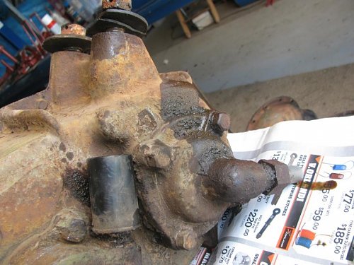

I decided that the transfer case was next to tackle so with Jill’s help and my trusty engine crane we placed it on one of the four poster hoists runways.
I like to keep the work area as clean as possible so a good layer of newspaper underneath the job will catch most of the crap and soak up the inevitable oil spills. First job was to scrape off the mud and debris build up before attempting to unbolt anything as with any restoration, you shouldn’t cut corners and just clean up a part and put it back on
Name:	Lynx SandblastHull 039.jpg
Every part of the Lynx is joined with earth straps and you can see here that even the two parts of the case are earthed to each other and then to the chassis.
Name:	Lynx SandblastHull 054.jpg
The Lynx uses a very shot strange type of coupling between the gearbox and the transfer case. This consists of a pair of Rzeppa disc type universal joints connected by a short shaft. This coupling is just like you find in most WWII military front wheel drive diff assemblies. Fortunately for me, the coupling was still attached to the gearbox and was in good condition. The balls were not rusted and after a really good clean and grease the Rzeppa joints were re-assembled ready to refit and as it says in the workshop manual, wrapped in a clean cloth until ready to use. These are the six bolts onto which the Rzeppa joint bolts.
Name:	transfer case CNN 001.jpg
I started the dis-assembly with the declutch unit and after removing the coupling, I carefully removed, measured and stored the shims behind the coupling.
Name:	Lynx SandblastHull 044.jpg

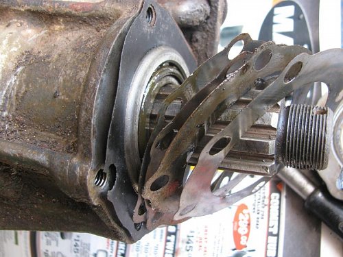

The transfer case was pretty straight forward to pull down. It is a single speed just like in aC15A or F15A, supplying drive to the front axle as and when required. The selector lever sticks up through the floor on the left of the drivers seat. Pushing it down to the floor engages the drive and pulling it up disengages the drive to the front axle.
  #84
Old 07-07-15, 11:03

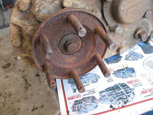

Next came the rear drive coupling, it was here that I found that the transfer case had been rebuilt some time during its military service. How did I come to that conclusion? It was fitted with a clearly marked GMH oil seal no. 2057128. That is the same number as shown in the manual.
Name:	Lynx SandblastHull 056.jpg
ID:	74859 Click image for larger version
Name:	Lynx SandblastHull 065.jpg
ID:	74861 Click image for larger version
Name:	transfer case CNN 031.jpg
ID:	74870 Click image for larger version
Name:	transfer case CNN 027.jpg
ID:	74871 Click image for larger version
Name:	transfer case CNN 007.jpg
I next removed the speedo drive and the breather caps before I started on the input drive coupling. A film canister served as a protection cap over the speedo drive for many years. I was able to locate a breather filter for the breather years ago so that was lucky too.
  #85

I measured the shims and replaced them exactly where they came from and then adjusted them to .003” to .005” on each one except the declutch unit which is set at ZERO. Something to keep in mind is that the thickness of the shims must be equal on both sides of the idler shaft.
A straight edge was used to make sure the gears were below the casing so that they would not rub on the cover. The detente spring should be checked and the ball examined to make sure that it will locate correctly.

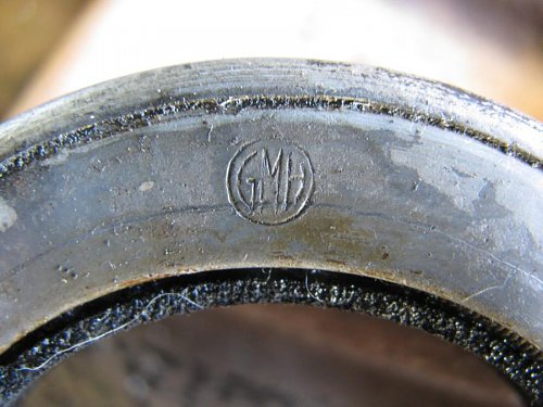

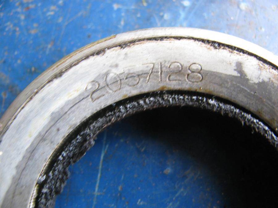

Once again I was able to purchase all the bearings and seals over the counter and I is lucky that I have a trade account otherwise it would have cost a H#!l of a lot more.

Next came the gear change tower. As the Lynx has the engine in the rear and facing backwards, the gear linkage has a pivot (known as the Bracket and Lever assembly) to change a push to a pull and vice-versa. (SEE Post #16 for those photos)
This pivot was re-bushed and so were the linkages where necessary.
Name:	Lynda Griffith082013 029.jpg
This is the tower as taken out of the chassis.
Name:	Lynda Griffith082013 033.jpg
There are packing gland seals at both ends of the rods and boy where they a challenge to replace. The gland nuts were seized solid and I did not want to apply heat as I needed to see the type and size of the gland packing. The gland nuts were close together too close to get a grip with anything I had in the workshop so made up a tool like the one you use to undo an oil filter only much smaller. After three or four tries with different straps I was able finally to undo and later tighten the packing glands.
Name:	Lynda Griffith082013 032.jpg
This is the inside of the tower showing the slides which press onto the base plate.

The marker lights were badly rusted and needed replacing.
The rusted right marker light.

I had looked around many swap meets over the years without any success. It looked like I was going to have to break out the lathe once again and machine up the rusted extension tubes. 38 years of collecting and a couple of moves meant that I had Lynx and other vehicle parts hidden all over the place. One day I was hunting for something and I came across a tin box I didn’t remember before. Opening it I found that there were 9 NOS marker lights inside. I couldn’t believe my luck. I have no recollection of ever purchasing them.
I pulled them apart and replaced the wiring. The springs were all OK and the white and red lenses were in excellent condition but the rubber gaskets were beyond repair. I punched out new gaskets out of thin neoprene after machining up some hole punches. It took quite a few goes to get the outside and inside punched out successfully as the gasket is only about 1/32" wide and thick. I then cleaned the contacts and fitted new globes all round. It was a bit hard to find single contact globes that fitted into the tubes so that the spring would seat the lens against the gasket to seal the unit.
Name:	Lynx rolling 028a.jpg
The new marker lights and new headlight drums after spraying them.
The painting stand came from a clothing shop and was very handy as it could be adjusted for height.
Rick.
