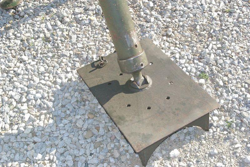

Here are a couple shots of various 3" baseplates. The early one is currently on ebay through Westland military antiques at only £550 ($900 cdn or so). The second one shown is from the Australian War Memorial website, and the third is off a 3" mortar presently available from Collectors source here in Canada. The last shot is a scan from the 1937 manual for the 3" mortar.
My 3" mortar has the baseplate as pictured from collector's source......small holes and the chain for dragging it around.

Darrin, the 1951 Infantry Training pamphlet for the 3" Mortar shows a barrel with a removable breech piece, describing it as the Mk 5 barrel. The square baseplate with large holes and a chain handle at the rear of the top plate is called the No. 6 baseplate, and finally the bipod having stamped plates ( rather than forged ) joining the 2 legs to the elevating screw tube is described as the Mk 5 bipod.
Now these different versions of these 3 items could probably all be used together interchangably! So you could have a mortar having a Mk 3 barrel, a No 4 baseplate and a Mk 1 bipod!
The Small Arms Training pamphlets for 1939 and 1943 show the one-piece tube, the tapered corner baseplate and the bipod with forged horizontals joining the legs, without giving any marks or numbers.
The 1937 Handbook ( reprinted by The Naval and Military Press and very informative! ) probably issued when the mortar was accepted for service starts with the Mk 1 barrel, but gives no marks or numbers for the baseplate and bipod shown.
There were, thankfully, only 2 marks of sight which have a different mounting system so this also entails differences in the bipod sight supporting bracket.
So to simplify I divide the 3 inch ( actually 81mm ) mortar versions broadly into two types, the early with the one-piece tube, tapered baseplate and forged bipod and the later type with removable breech piece, square baseplate and stamped bipod.

Darrin,
I have some information on the 3 inch mortar base plates pertaining to Australia:
(1) pre-war and early war base plate Mk.1: as per the image in the Mortar Carrier handbook. Same as the Brit mortar plate.
(2) circa May 1943 introduction of the No.4 Mk1 base plate: essentially the same shape as the Mk.1, but with increased ribs and strengthening pieces to cope with higher incremental charges, as the Mk.1 was found to bend when firing higher charges. Most obvious differences were underneath, where there was substantial increased ribbing (and greater weight!). This appears to be the one illustrated in the book page image posted by Rob Love (above).
(3) In early 1945, certainly before June 1945: introduction of the base plate No.6 Mk.1(Aust), which is the square one with the two rope handles, as seen with mortars issued post-war. The plate was introduced to cope with the increased recoil of higher incremental charges and to be several pounds lighter in weight than the No4 Mk1. This remained the service base plate post-war until the withdrawal from service of the 3 inch mortar.
I'd suggest that finding either a Mk.1 or No.4 Mk1 base plate in Australia will be very difficult. You perhaps might find one overseas.... then you have to get it to Oz .... and past customs.
