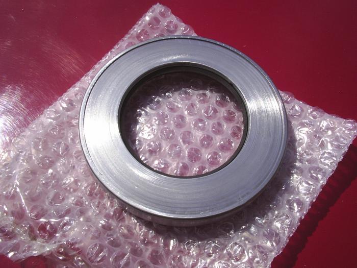

Doug,
I do not have the new seal as yet, but here are the technical details.
The British army stock number of the seal was LV6-MT1/PT/475227, this denotes it was a Perfect oil seal, with part # 475227, this is stamped on the old seal ( for confirmation).
The Outside diameter is 4.756", Shaft diameter is 2.85" and Width is 5/8".
regards, Richard
Old 15-06-11, 00:32
Originally Posted by Doug Lavoie View Post
Richard,
Could you post the info. on the seal when you have it home?The dimensions, material etc.
Thanks,
Hi Doug,
Here is two views of the newly made pinion seal ... lip material is nitrile rubber.

Richard,
That looks just dandy. Nice work.
Doug
