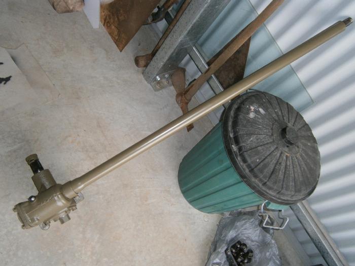

Default Steering Box Finished
Steering box now finished. I had originally chosen the best sector shaft & best worm gear shaft, but despite several attempts, I could NOT get them to work together without binding mildly in what would be roughly straight steering. Had a re-think and tried the other worm gear shaft. Bingo! Smooth rotation from lock to lock. When adjust fully, it is now possible to turn the worm gear shaft by twisting the sector chaft alone. These two parts had been a pair for 70 years and they still work perfectly together.
Assembled the box fully yesterday PM, after returning home from photographing those old CMP wrecks. Checked the assembly this morning and found some oil weepage from both of the bolt on plates. Very minor, but shouldn't be any leaking there at all, they both have brand new gaskets. Re-torqued the bolts this evening, for another check in the morning. I would hate to think I need to remove the cover plates for some reason
Name:	Steering box finished 1.jpg
ID:	52885 Click image for larger version
Name:	steering box finished 2.jpg
ID:	52886 Click image for larger version
Name:	steering box finished 3.jpg
Heres a small glimpse into the distant future.
Name:	steering system 1.jpg
The new sector seal was installed easily but painfully. With weather being so hot, I put the bare steering box in the sun, and the seal had gone into the freezer the night before. Upon removal from the fridge, the oil that seal was sitting in had turned thick, as thick as treacle! When I took hold of the steering box after sitting in direct sunlight for 4 hours, it was VERY hot. I unwittingly reenacted the scene from Indiana Jones where the bad guy grabs the medallion thats been in the fire. The difference being, the writing wasn't as clear on my palm......and i'm not a fascist nazi bully boy.
With the differences in temp, the seal could be tapped in easily. At least that bit doesn't weep oil.

P.S: steering box gaskets x2 still weeping. Bastard. I will look for another type of gasket paper while at hydraulic shop tomorrow A.M. I'm worried now, because the same paper was used on jointing two halves of rear axle some time ago. Oil not yet put into the diff casing. Must do so prior to replacing axle onto chassis!

Disassembled the steering box again yesterday, and put it back together with fresh gaskets. This time I coated the surfaces of gasket & metal with lashings of sealant. This morning, I anxiously checked for leaks before leaving for work, and found NOTHING untoward.
Now, every gasket I replace will have this treatment. I have never used sealant before, but won't do any future work without it.

P.S: Found the steering box STILL weaps oil through the sector shaft adjusting thread cap and locking ring. I already slopped these with gasket sealant, so no more stuffing around. Bought a tube of the 'semi grease' that someone mentioned here once.
A specially produced grease for vintage (read as leaky) steering boxes and gear cases! Take that, evil steering box.
