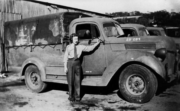

Hi there!
Well there are a few other features that indicates it is not of Australian origin:-
*door ribs, Aust 40~41 Ford had 3
*spare tyre, Aust Ford Ute had it mounted on the left hand side. (tool box mtd on the right hand side)
The attached photos the 1st with the guy is a Aust 1940 Ford and the 2nd with the woman is a Aust 1941 example.
Phil...
