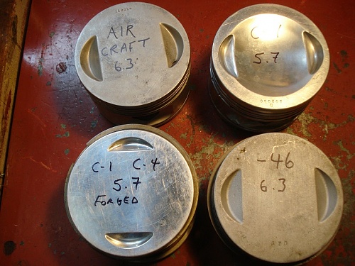

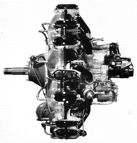

I wanted to revive this thread to address the issue of using lower cost 975-46 engines as a parts source for tank engines. I have had the good luck to aquire a couple of these high horsepower helicopter engines and will share what I have learned about them. Please include your comments and experiences with these engines. There are still very nice -46 engines available for reasonable prices. These are helicopter engines, some of which can produce up to 550 hp ( take off) using high octane aviation fuel (100/130 or 115/145). These are the ultimate refinement of the R975 engine and were designed and built by Continental after WW2.
ID:	102395 Click image for larger version

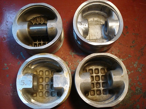

The initial impression you get is that this is a much more heavily built engine. The crankcase is heavier, the rear crankcase is simpler and heavier than a C1 or C4 and the magnetoes are larger, the carb huge! In front a larger oil sump, a longer crankshaft (as per all aircraft engines and cylinders that are bigger than C1 but smaller than C4s. The thin web of a C1 or C4 crankcase is easily damaged either by rod damage (piston fails striking sides) or when bearing ejecta is smashed between the case and rotating crankshaft counterweights. The -46 case is solid where cylinders mount and much sturdier.
Inside there are several other differences. Pistons in C1 & C4 engines are 5.7 comp ratio (early ones cast later forged) while aircraft and the -46 are 6.3 comp ratio ( though higher ratios were used in prewar aircraft engines). All tank engines use "square" comp rings. The -46 and some aircraft variants use tapered keystone compression rings. The tapered rings are widely used on diesel engines and are currently used on the standard Continental 1790 diesel tank engine. A variety of oil scraper rings can be used. Note that all the forged pistons have reinforced ridges in the back, only the 202050 cast has none.

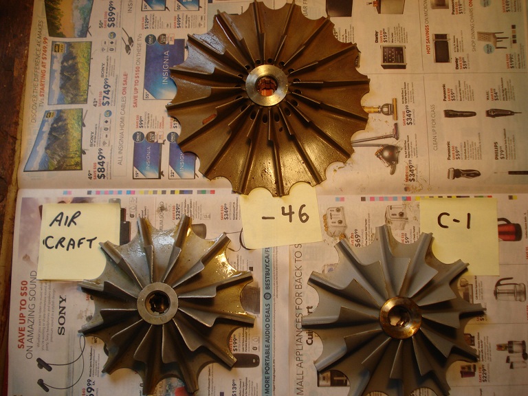

All early aircraft engines and C1 tank engines use a 6 7/8 inch impeller with 12 vanes. I do not have a C4 impeller but the manual shows what appears to be a larger diameter impeller with 16 vanes. Can anyone provide outside dimensions? The -46 impeller is 8 1/8 inches diameter and has 16 vanes. It also has holes through to the back.
Valves in the -46 and C4 have larger diameter stems than C1, and are not interchangable. I believe the -46 exh valve has an even larger diam stem than a C4.
Crankshafts, of course much longer in aircraft applications than tank engines but the C4 and -46 use a single nut and sleeve to hold the two front bearings in versus the earlier two nut method of the C1. Could you cut down a -46 to work in a C4?? Not sure.
ID:	102398 Click image for larger version
ID:	102399 Click image for larger version
ID:	102400 Click image for larger version

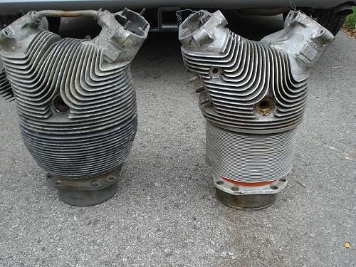

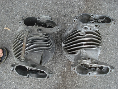

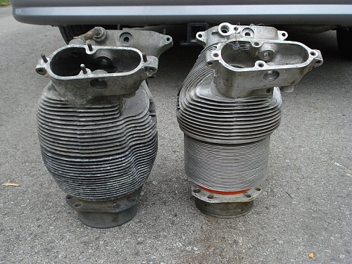

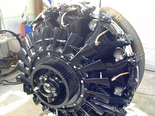

Cylinders- I was prompted to provide this information by an internet photo of a C4 engine that appears to have been rebuilt using -46 cylinders. This seems like a great idea given the scarcity and high prices of C4 cylinders. Hopefully one of the forum readers will recognize the picture and provide details on this rebuild. I assume it will require custom baffles around the cylinders.
ID:	102402 Click image for larger version

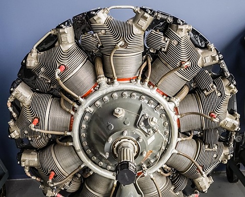

Default Continental R-975-46A radial: from aero, to tank, to aero engine
Hello Bob,

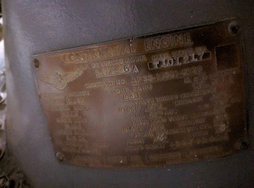

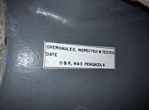

Over a year ago I came across pictures of a Continental R-975-46A radial engine for sale for not too silly money. I too wondered about the interchangeability of parts, or even a complete engine swap into a M4 Medium tank or related AFV.
Thanks for offering some insight into the detail differences.
PS: Here's what I found about about it:
Aircraft variant of the Continental R-975. This is the -46A version as used post-WW2 in the Piasecki PV-18 (Navy HUP-3 Retriever, Army H-25A Army Mule) helicopter. It was offered for sale on the Antique Aircraft Parts Exchange FB group, and shared here as it may be of interest to Sherman tank restorers. While originally a Wright design, during WW2 Continental built more R-975's under licence for tanks than Wright did for aircraft (> 53,000 vs. >7,000). After the war, Wright showed no interest in continuing to manufacture the R-975. Continental then introduced its own R-975 version for aircraft, the R9-A. It was basically similar to other R-975 engines, and its compression ratio and supercharger gear ratio were unchanged from the R-975E-3, other improvements in the R9-A allowed it to achieve 525 hp (391 kW) for takeoff, surpassing any Wright version. A military version, the R-975-46, could reach 550 hp (410 kW), and was used in Piasecki's HUP Retriever and H-25 Army Mule helicopters. Continental's production of R-975 engines continued into the 1950s.

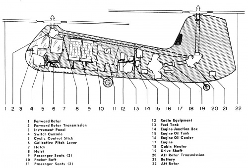

Power to the HUP-1, HUP-2 and HUP-3 helicopters is supplied by Continental R-975-42, R-975-46 or R-975-46A air-cooled, nine cylinder radial engines. These were based on the Wright-designed tank engine.
The engine is located within the fuselage aft of the fuel cell and firewall. It simultaneously drives two three-bladed rotors through drive shafts and reduction transmissions. The rotor blades of the HUP-2 are of either wood or metal (later versions) construction.

One of the significant improvements with C4 cylinders was that the cooling fins were made much bigger with bigger gaps between them as the very fine fins on the EC2/C1 and presumably the -46 engines clog up with dust in tank applications.

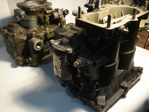

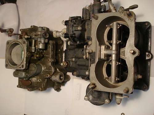

The idea of using a -46 in a tank is tempting but I think it has fundamental dimension issues because the crankshaft is significantly longer. Then the cooling shroud would have to be redesigned to the longer length, unless... you machined the front crankshaft shorter. I think it could be done ( will post c/s pics later). The engine in post #12 is probably intended for an automatic transmission vehicle (M18 ) and has no clutch. The cooling fan around the front shaft is for the oil coolers. I had one of these engines and (sadly) I let it slip away.

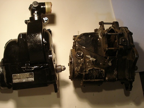

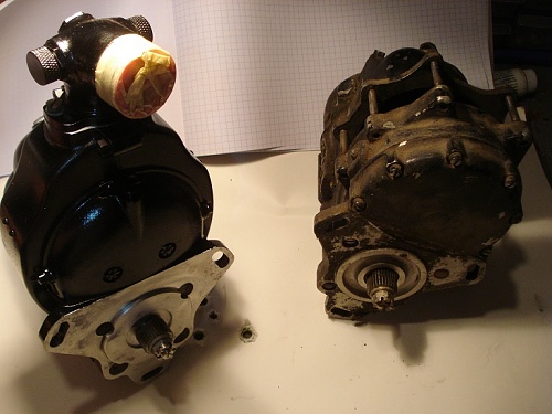

Here are some more photos the C1éC4 carb ( stromberg NA9RG) versus the much larger Stromberg QD 9A1 of the -46. Also magnetoes , two types used on the -46, the SF9RN which looks very similar to the C1 and C4 mag (VAG9DFA), and another type SF9RN-8 which was an automatic retarding mag.

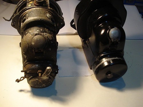

On the bottom mag picture the C1 C4 mag is on the left and has the small rotating aluminium cap. The -46 was used in some crop duster aircraft applications and I understand they used a smaller carb and just covered up the two barrel intake with a plate with a single hole.
Inside link rods are interchangable but the knuckle pins and master rods are not. The diameter of the end of the knuckle pins is different.
The -46 is an impressive engine and the culmination of decades of refinement on the 975 engine. The 1950s was the era of overkill in radial engines with mega engines with as many as 28 cylinders arranged in four rows were built. What a mechanical marvel but also a mechanics nighmare!

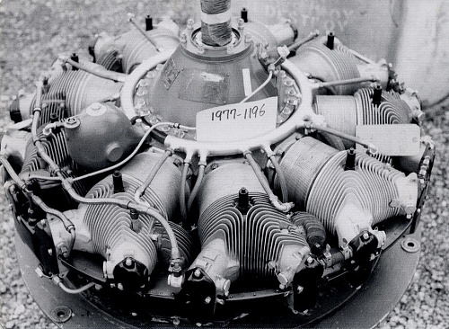

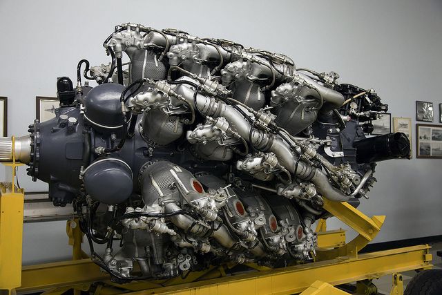

P & W 3460, 28 cyls 3500HP

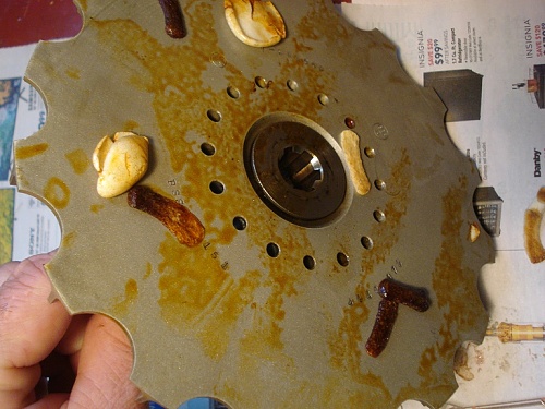

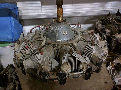

Here are a couple photo's of a new C4 supercharger impeller. Outside diameter is 8.875", 16 vanes, .750" 6 tooth spline.
In my opinion, the bane of the radial is the seperation of the two angular contact bearings on the supercharger impeller shaft. Angular contact bearings are meant to be used in pairs, as they are on the impeller shaft, BUT they are designed to be installed back to back to give the bearings the proper preload. Seperating the bearings on the impeller shaft necessitates very precise shimming of the housings so the bearings run neither too loose or too tight, as they run up to very high speeds.

Perry thanks very much for the impeller info! Looks a whole lot like the -46 impeller, does anyone know the significance of the holes through to the back?
As I mentioned earlier in this post tghere were weak points in the 975 engines, the impeller shaft/ bearings were certainly one. A second was the master rod/ crank bearing which often failed due to abuse or possible oil starvation. Any other known issues?
I also need to thank Perry for the opportunity to photograph his C4 cylinders next to a -46 cylinder. Please note -46 cylinder does not have an exhaust elbow attached.

I would suggest that the holes in the impeller are to more balance the pressure on each side of it as without them it would draw itself towards the side with the vanes on it (as it sucks air from that side) causing high axial load on its bearings. A certain amount of recirculation will happen but it may be that that was judged to be the lesser evil.
In my experience the primary cause of failure of these engines (in preservation) is that people let them idle at too low a speed and the master rod to crank bearing fails due to oil starvation as most of the lubrication pressure of this bearing is from centrifugal force within the crank itself and that is negligable below 800rpm. They will idle nicely at 500rpm so people think that that is better - wrong !
Old 25-09-18, 07:47
Malcolm Towrie Malcolm Towrie is offline
Location: Whitby, Ontario, Canada
Posts: 306
I looked after about 1500 pumps in a nuke plant and I agree with Perry. Angular contact bearing pairs must be shimmed or matched so that the axially unloaded bearing (not the loaded) is still preloaded enough to ensure the balls roll and don't skid. Skidding causes nasty damage to happen. Modern Vortec blowers which spin up to thousands of rpm are supported by tiny angular contact bearing pairs and your best bet for a good rebuild is to send them back to Vortec, IMO. It's that tricky to set them up.
And I agree with David. The holes in the impeller back shroud are to reduce axial load on the shaft bearings. This is common practice in pump design. The holes bleed the discharge pressure seen on the back side of the impeller back to the suction side. This reduces the thrust load towards the suction side.
Malcolm

I learned from a pump manufacturer that the holes are to relieve the vacuume pressure, not to protect the bearings, but so that sewage (or oil in engine application) doesn’t get sucked past the seal.
