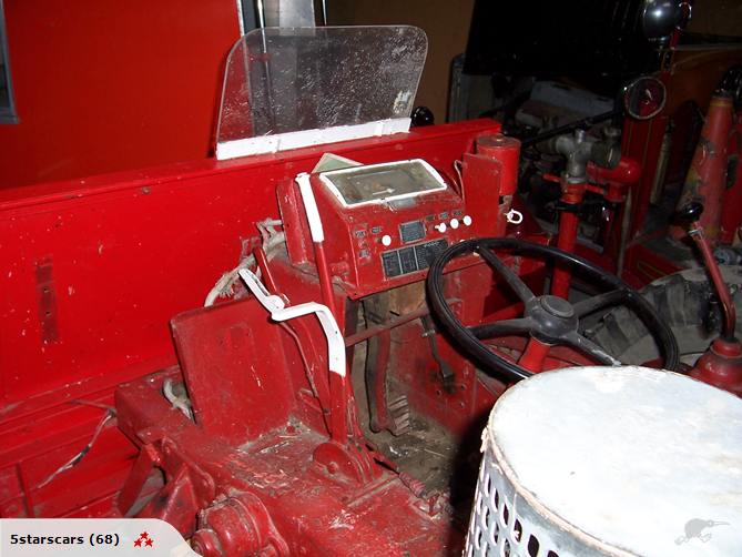

Default Indian pattern carrier chassis x 2
On Trademe, converted to fire tenders Auction number; 319764811
Old 24-09-10, 12:22
Excellent find!
For (future) reference: http://www.trademe.co.nz/Browse/List...x?id=319764811
Ford Flathead V8 Quads x2
Asking price: $0
Listed: Thu 23 Sep, 12:12 pm
Listing #: 319764811
Here we have a couple of ford quad flathead V8 forrest service fire tenders that were originally army scout cars.
Were converted for the forrest service back in the late 60's
One tanker and one pumper.
The pumper is understood to be the only one made and the tanker one of approx 27??
Both understood to be ex Eyrewell Forrest
Tanker needs work but is almost complete.
Pumper has 2 V8 engines, one for drive and one to pump. Also has log book
Pump is an original trailer pump with the axle and drawbar removed.
Pumper is understood to be a runner, but I have not had the time to run either engine.
Change of circumstances means that these are reluctantly for sale.
Will consider offers around 6k
Seller's Details: 5starscars (68 )
Member since May 2002
Located in Rangiora, Canterbury

Not indian pattern, New Zealand Pattern.

Ok, well the story goes that the Indian pattern carrier has a rivetted hull and is based on a different chassis to the NZ pattern. The Indian pattern carrier's steering column is in much the same place as it would be on a truck, but the kiwi one is low between the chassis rails. I can't remember the chassis numbers off the top of my head, but they are quite different. The kiwi carrier hull is of welded construction and has 20" split rims, where the Indian has 16" split rims. When the first hull was made, modifications had to be made to the mud guards to give clearance for the 20" rims. All up I believe NZ recieved 100 chassis, but I can't remember how many were turned into operational vehicles. In service the Wheeled carriers were found to be utter crap. They were used for home guard I believe during WW2 and saw service in Korea. Many ended up as range targets and the rest as Forestry fire tenders such as in that trademe auction.
