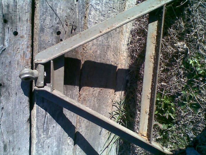

Default Towing bracket

This is the standard US pattern T ring which was used on the M113 and others. The tow cables with the oblong opening on the end slipped over the T and then turned straight, so it would not fall off if the towing cable went slack.
