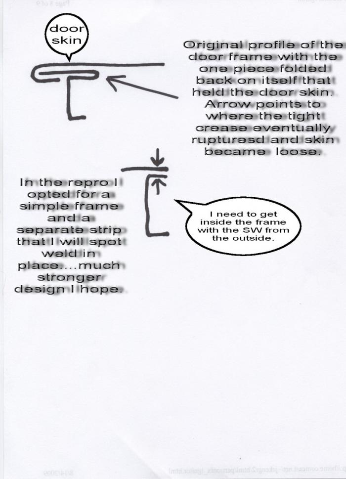

Thinking of replacing my copper electrodes on my spot welder to reach hard areas....... yours looked more adaptable.....
What is the exact diameter of your copper rods...where they fit in to the main body........?
Boob
Hi Bob
Here is the information on the spot welding prongs, the first picture shows my collection of prongs, while my HTP QuickSpot II Spot Welder uses welding arms which are at the mounting point Diameter of .787 inches or approximately 20MM. http://www.htpweld.com/products/spot...quickspot2.htm http://www.htpweld.com/products/spot...ersatongs.html
Over the years I have also used prongs or welding arms which are for the made I believe made for the Hobart http://www.hobartwelders.com/product...ips_chart.html http://www.hobartwelders.com/products/spot/hsw/ and others which are smaller in diameter by using brass bushings to match the size. The other tips I have are .625 inch diameter.
You will note that the long tongs are covered in rubber this is just sheet rubber to act as insulation so that the tongs don’t ground out on when reaching in to a deep point.
Hope this answers your questions.

....so no matter what they say in these Men magazines.... size does NOT matter if you use a brass sleeve........ hummm!
The one I need for the doors is the bottom RH on the first picture also shown as the top LH on the second slide.....
I need to reach inside the frame and clearance is a problem.... like the idea of a rubber sleeve to make sure the pwoer goes where it is intended.....
Will be measuring tomorrow.....

See picture of the door profile.....
