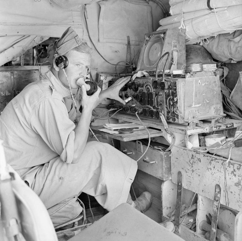

Came across this picture, thought I'd share it with your radio guys
"British signaller at work in a radio truck" - somewhere in North Africa

What stands out is the speaker . It is a speaker from the artillery battery telephone set , they had a speaker unit at each gun, the instructions came from the base unit . These speakers were carried two clipped together . I had quite a few of them plus the base unit . They were not meant to be used with a No. 11 set or any wireless set . The speaker had a button on top, you pressed the button and spoke back to the main unit , it was a two way setup.

Thanks Mike. Very interesting picture which I've saved in my PU folder.

No thanks Ron. Can you tell if the signaller is seated in the back of a PU or another type of vehicle?
Old 05-07-16, 04:18
The 1A2 bodies on the F8 and C8 don't have that storage space at the floor to the right of the operator's foot.

Hanno it looks exactly right for a British PU to me. The storage space by the operators right foot is actually three pockets to store 'satchel Signals' You can also see the 'Switchboard charching No1' behind his left shoulder. Ron

as Mike said they weren't designed to be used with our sets but mine works fine with my ZC1. Looks good and gives the gear a bit more impact when at public displays.

I like the operator's thumb on the big white 11 set send/receive lever.
