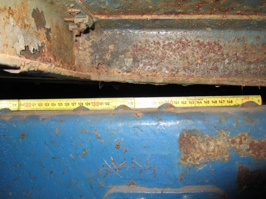

Posts: 14,943
Distance between datum points "D" and "E":
Datum point "D" (left) and datum point "E" (right) - distance is 150 cm:

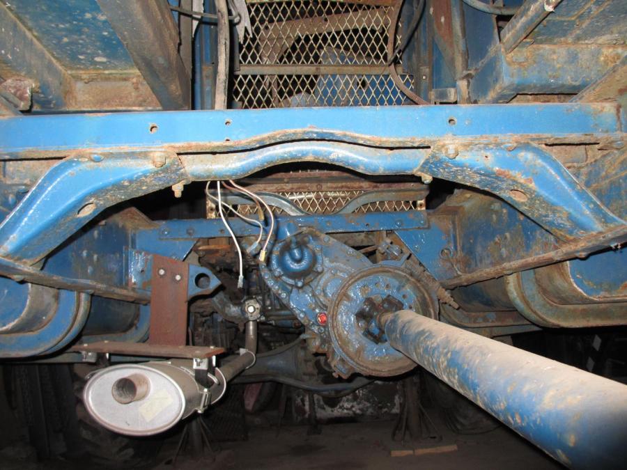

Old 07-12-14, 13:50
Posts: 14,943
PS: don't be confused by what you see sitting on the chassis in some of the pictures - the cab is removed from the chassis and sits much further back:
For reference, the C30 has one extra cross member between "D" and "E". The C60L has two (see right hand drawing):
