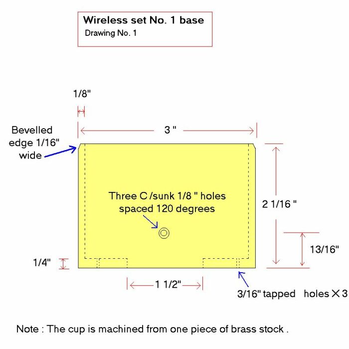

Hey, we have been looking for the toothed base plate forever ... we , I mean us PU 8 cwt wireless truck owners . I do have the upper section - the brass cup and the mushroom shaped insulator ..these are super rare items . The lower toothed base plate , your pic shows it , has turned up at last ! I'll tell Rory Ballard about this find of yours.
I made some detailed drawings of the cup and insulator ..will try to locate tham and post here .
Would be interested in any drawings or the actual repro toothed base plates

Default drawings
found the drawings
