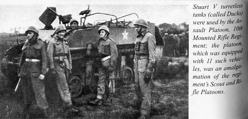

Crewman, somehow I recall that the Stuart VI's used by the Polish 10th Mounted Rifles Regiment were turretless Recce tanks. Can you confirm this, please?
I knew I had seen a pic somewhere! It is featured in Polish Armoured Forces 1939-1945 by Zbigniew Lalak.
Who knows where the Polish 10th Mounted Rifles Regiment were in combat?
