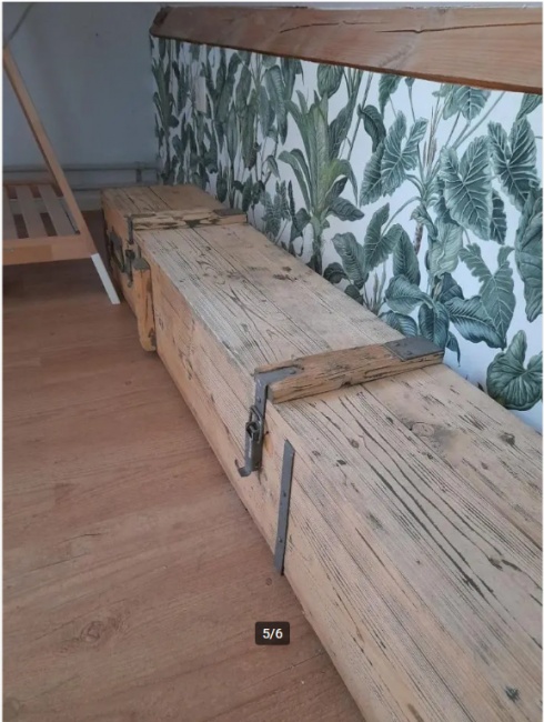

Default Is this one?
Is this a Bofors spare barrel box? Note it has been sanded down to serve as a piece of furniture.
"length 3.07 meter, width 26 cm x height 28 cm"

Old 14-07-23, 15:57
Posts: 7,644
Whatever your crate is for Hanno, it is not the British version. The latches look like the ones on some of the Finnish tool and spares chests that I have for mine.

Old 14-07-23, 18:14
Thanks Rob, that’s a big help.
Alex found the wooden box I posted above on a site and suggested to a mutual friend with a Ford F60S LAAT this may be a Bofors spare barrel box. Now seems it isn’t one as it is considerably longer than the wartime one.
Old 14-07-23, 18:42
Adrian Barrell
Location: Suffolk, UK
Posts: 862
It might still be a Bofors spare barrel box, just for the L/70, rather than the wartime L/60. Is it about 400mm longer?

Old 14-07-23, 23:13
That’s what Alex suggested, too. The one for sale is 45 cm longer compared to the dimensions listed by Rob.
