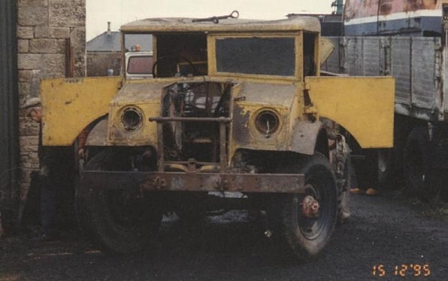

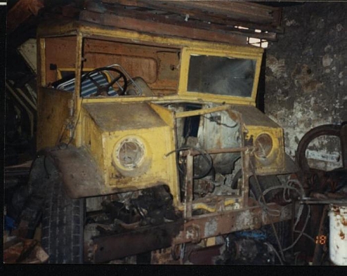

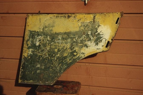

The attached picture shows an original Census number showing through as I stripped the paint off a CMP 13 Cab door.

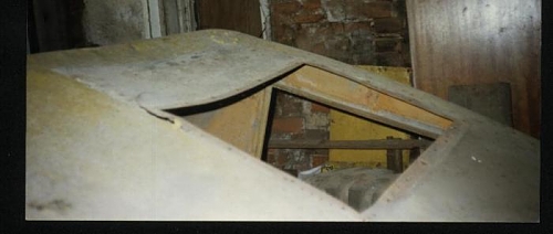

However the cab was on a LIME SPREADER used by an agricultural contractor for 20 years. The chassis is a F60S 101 1/4". w/base.
Square roof hatch model,
Welded front radiator cross bar where bonnet sits.This was hacked through when the FORD 4D diesel was stolen way back in the Sixties.
I guess it dates it at 1942/43 build.
NOTE the cab pics as found show early cab crash bar mounted behind front Bumper / Fender

Although the chassis had front winch fair leads the chassis frame only had a heavy steel spacer bar between the chassis rails.
I believe that the builder of the Lime spreader had BUILT the cab onto an EX Gun tractor chassis. and used various parts of other broken/ dismantled vehicles.
So even if the number was fully readable I could not be certain that this door and this number came off the same chassis.The metal contract plates are missing.
Can any one point out where i might find the CHASSIS number on this chassis frame, which sits waiting a rebuild in a friends barn.
stephen
*snip*
Stephen,
As the wheelbase is 101-1/4 inch, and the chassis has fairleads, this is indeed most likely an ex-FGT chassis. The F60S had a 134" wheelbase.
Sorry, I have no info on where to find the chassis number.
P.S. I have moved this to a separate thread to increase the chances of people finding it.
