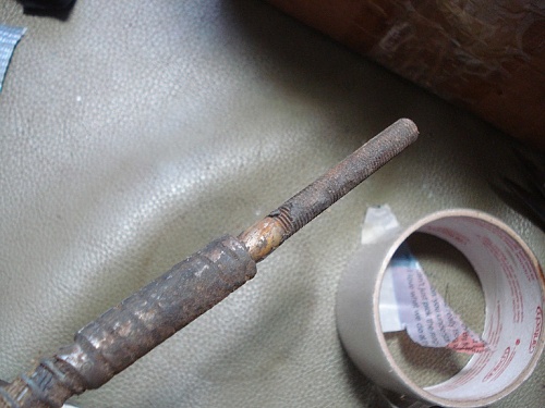

Hello,
I'm looking for a set (2 no.) of E-Brake/handbrake cables for my C15 Chevrolet, part no. *1799285, if anyone can help.
The cables are approximately 920mm (36-1/4") in length, and look like the attached (minus the rust!).
Thanks,
Owen.
C15 handbrake cable.jpg   C15 handbrake cable - pivot end.jpg   C15 handbrake cable - wheel drum end.jpg

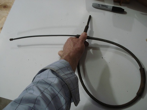

Owen,
I also had difficulty finding cables for my C8. I am sure you could fabricate something from commercially available brake cable parts that would do the job nicely, but if you want something that looks original, than it's a bit of a challenge.
Both the C8 and C15 (and also C8A) seem to have used cables with a eyelet at the end, while most Chev cables at the time had a threaded end (again, you could probably make that work). NOS Chev brake cables are offered on Ebay quite regularly and even though I haven't quite narrowed it down, the eyelet type cables seem to have been used from 1936-1940.
Have you checked if a shorter cable would work? Cables with eyelet end and about 31-32" overall length are offered on ebay regularly....longer ones are a bit more scarce. I bought two of the cables attached for my C8 recently. They are 38-1/2" overall length according to the Master parts list....which will hopefully work on my C8. There is a Left and Right version, but I have only found two Left ones so far.....so, if you find two right ones, let me know and we can do a trade
Hope this helps!

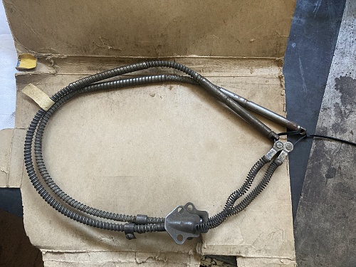

Picked up a couple of NOS brake cables from Mike Borth (http://www.borthautoparts.com), GM part no. 592283. Thanks to Alex for the part number!
They are about 1 inch longer than the original C15 ones, but have the same ends and should work just fine. And they look correct too! Mike may have a couple left, if anybody else needs them.
Thanks for all your help folks.
Owen.

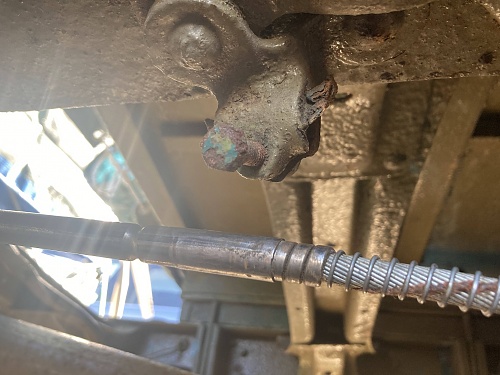

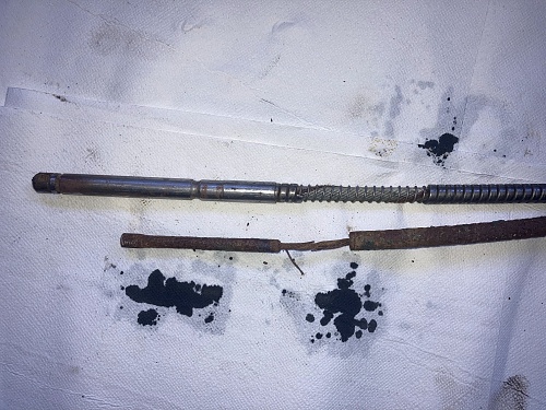

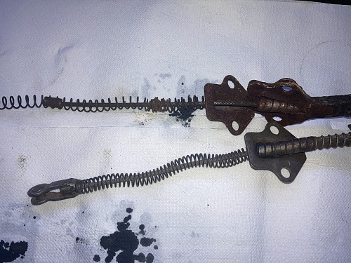

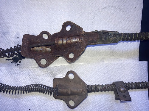

Have borrowed Alex's cables to compare with the original C15 cables.
The fitting which is clamped around the original cable guiding the cable into the brake back plate may well be reusable. The other end should fit in the chassis bracket. I could not test fit that because part of the old cable is still rusted in there.
Like Owen said, they are a bit longer than the original ones. I do have a concern that the end which protrudes into the brake drum is too short.
If I cannot find the original Part no. *1799285, I may end up taking my old cables to a local shop where the manufacture control cables. They said they can manufacture practically any cable, sometimes even using part off the old ones.
