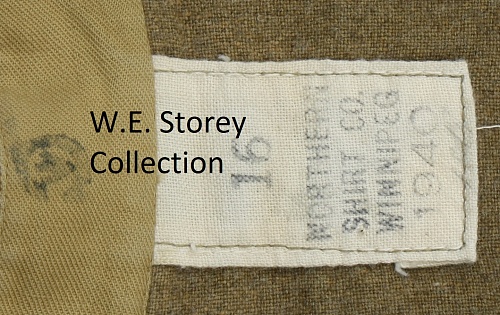

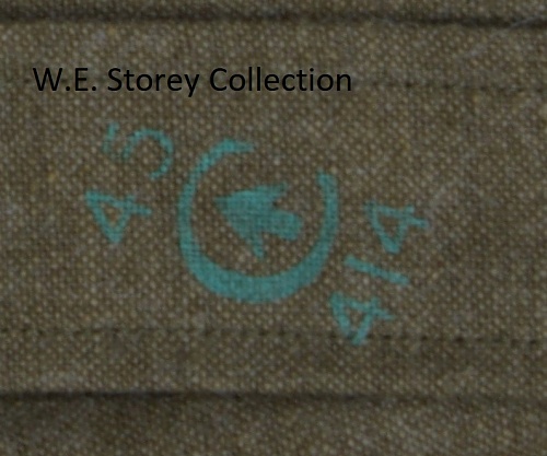

Old 11-11-21, 13:28
Posts: 1,731
Default Canadian C/Broad Arrow Markings
I think the C Broad Arrow was used as both a property
and an inspection mark.
