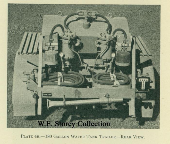

Here is an image of the 'business end' of this Trailer.
http://i43.photobucket.com/albums/e3...r-RearView.jpg

Thanks thats a realy good start, there are some differences between my 2 trailers and your photo but now I can see how it works and whats missing !!!!!! cant see me ever finding all those fitting so a lot of fabricating will have to be done, do you have any more photos please ?
