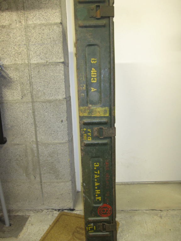

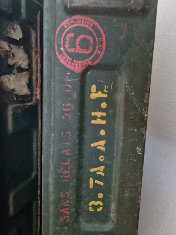

Hello,
I need your help on this box.
This is a 3.7 A.A.H.E metal box, dated 1942 with canadian stamp and French words (?)
It would have been found at north of Caen.
4/50, is it a date ?
Converted 6/51, is it a date ?
French words "SANS RELAIS", painted with same red paint than War Depatment stamp. Does it is WW2 ? a used by French army after war ?

Everything in the SWW militaria world is apparently found 'north of Caen'. The box and original markings are from the SWW but the French markings indicate post-SWW use. What you have is an excellence example of post-SWW Mutual Aid to a NATO Ally and should be preserved as such as history did not stop in 1945. Congratulations on a nice find!

The War Department stamp is a superseded Commonwealth system of Safety Class for transport, Class 6 being Explosives. These days, it is replaced by the UN Code for Dangerous Goods, now Class 1.1E Explosives.

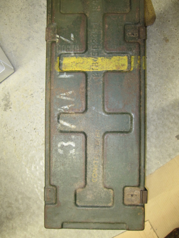

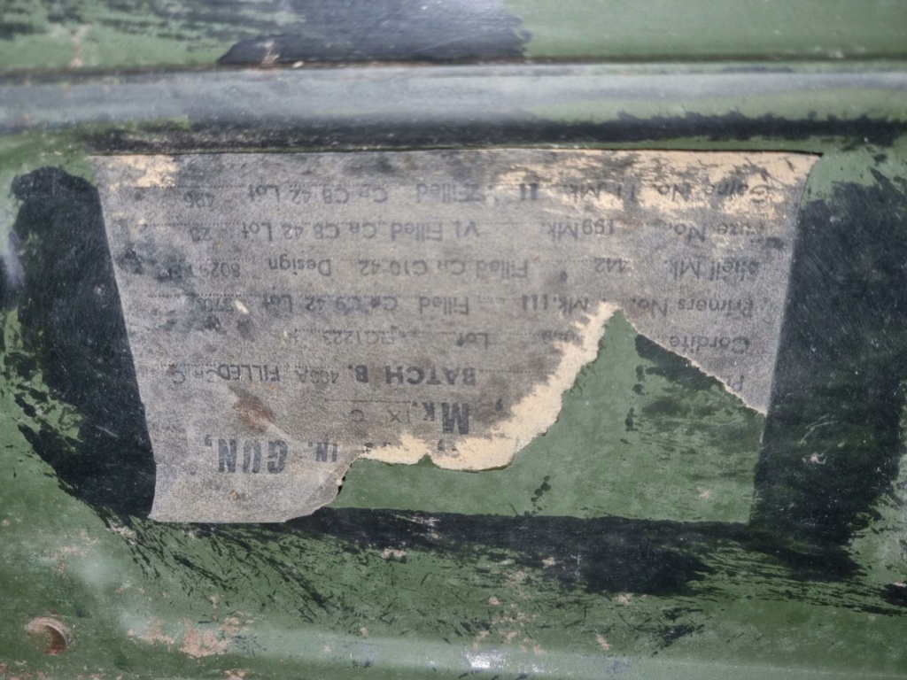

Hi Sebastien,
I can assist with the interpretation of some of the markings, if this would help.
Image 1:

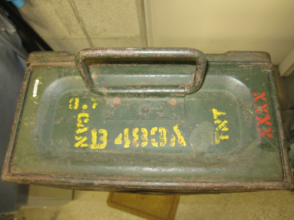

XXX in red indicates the ammunition is suitable for use in hot climates, so essentially all climatic conditions.
3.7 is the gun calibre, ie the 3.7 inch Heavy Anti-aircraft gun.
B843A is the ammunition batch number and sub-batch ID letter.
TNT indicates the explosive type inside the projectile

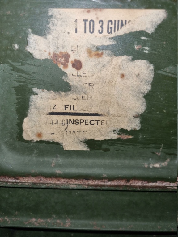

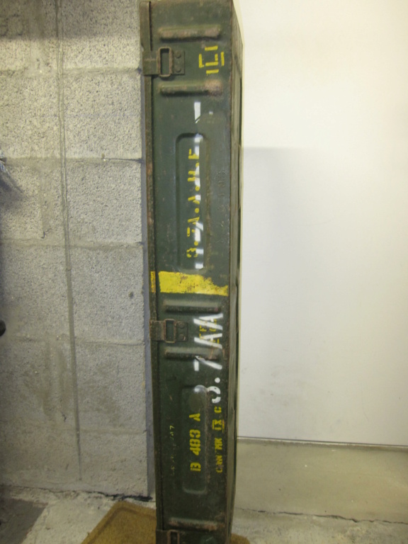

Image 2: the yellow markings are WW2, the white markings are post-war overwriting. Note the 'AA HE' has been blanked out in white. See image 3 below for the reason.
The 'L' in a square indicates the propellant is Flashless Non-hygroscopic nitro-cellulose powder usually abbreviated to FNH or FNH/P.
Other markings as per image 1.

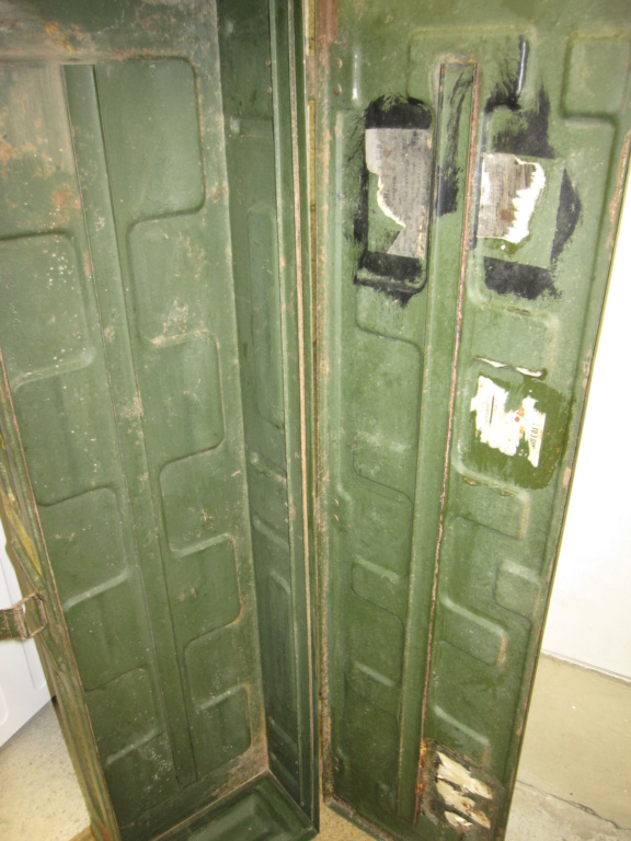

Image 3: the yellow stripe indicates the ammunition within the box has been converted for practice purposes.
FCC is the Fuze Factor Correction.

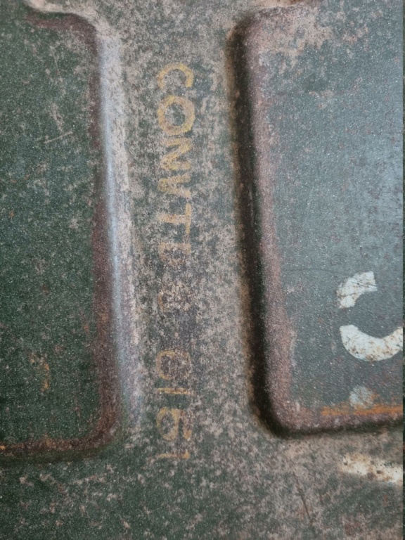

Image 5: yellow stripe = ammunition converted for practice purposes
Image 8: The rounds were examined by an ammunition technician for any defects in April 1950.
Image 9: 'Converted 6/51'
Image 10: as per Tony's comments regarding the explosive label.
Hope that helps. A fine example of an ammunition container with plenty of verifiable markings.
