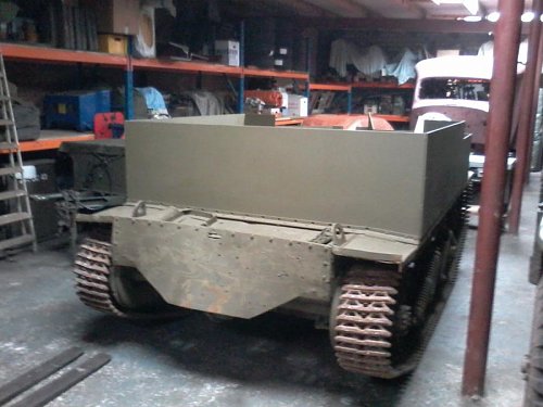

My name is Marcel Both and lives at the Netherlands(Close to Rotterdam) and since a 2 months owner of a UC.
Here are some pictures of my UC so you can see there is a lot of work to do.
The top armour is already new so no ID numbers but at the low hull(at the backside) there is the number 10115 C so far i know it is a Canadian Carrier
of they year 1942.
We have check the engine what was with it but this one is in very bad condition
so we have to look around for a other engine.
Soon some information about the progress.
Marcel
