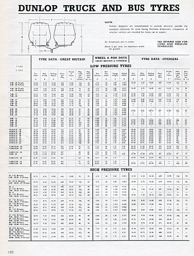

Hi Terance,
Here is one of the most useful things I've ever used for reference on all these British/Overseas tyres:
https://postimg.cc/S2dc3hSq
HTH
Cheers!
