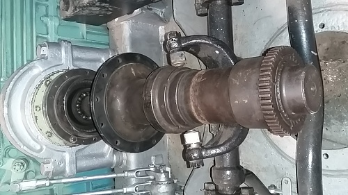

I think we have it figured out, Lauren. We're using the shaft from a old clutch installed between the engine and the gearbox. And using magnetic based dial indicators or maybe a laser alignment tool if I can borrow one to measure runouts at gearbox and engine ends.
The photo shows the shaft mounted to the gearbox. We don't have the engine in yet.

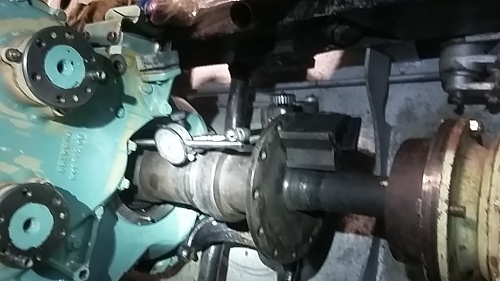

To close the loop here, I got the engine and gearbox aligned. Using the shaft from an old beaten-up clutch we had worked well. If you don't have an old shaft, seems to me you'd have to make something similar, which is quite a machining challenge.
I got really lucky. The runout readings taken with the dial indicator on the gearbox flange face and the crankcase face (see photos) indicated the engine was sitting about 1/4" low, relative to the gearbox. I made shims out of 3/16" plate and installed them under all four engine mounts. That brought the total indicated runout down from 0.060" to 0.020". Another 0.075" under each mount brought the TIR down to 0.008", which is within spec.
I was dreading this job, but it turned out to be simpler than I thought. I suspect that is due to the factory ensuring that the gearbox mounts and the engine mounts are parallel and that simply shimming up and down will correct misalignment.
I also suspect this spec is far too conservative for those of us running Centurions today. We're more likely to do 3 miles a year rather than 3000. So wearing out clutch, crankshaft, and gearbox components is pretty unlikely.

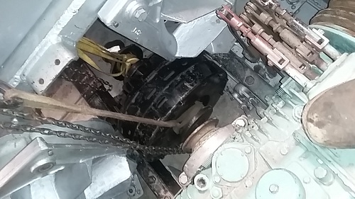

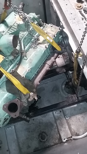

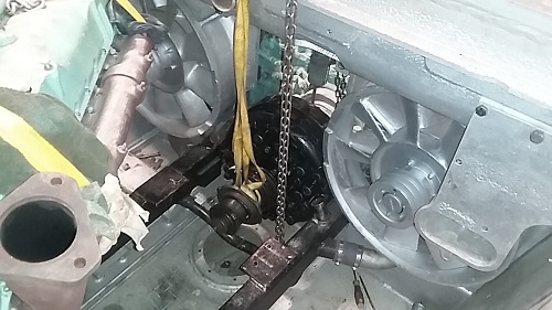

An update: I finally have the clutch installed in the Centurion, or at least in place.
We were held up tracking down a lip seal for the clutch, the one that seals to the crankshaft. It's installed in a crankcase cover that's part of the clutch assembly. You can see it in the first photo. The original seal was 4 15/16" outside diameter. Despite Garlock and Timken making a large selection of inch-size seals (and probably others), they are a bit limited on the 1/16" increments, especially in the larger sizes. So we bought a 5" OD seal and bored the cover out to suit.
With the clutch finally assembled, I then struggled to get it installed with the engine and the transmission in place, the engine loosely, but the transmission fully installed.
What did the trick was supporting the engine in the hull with the gantry crane at a 45 degree angle to the centreline, and unbolting the left-hand fan so it could be pushed back towards the transmission. I then dropped the clutch in beside the engine and finagled it into place.
That was the last major hurdle to getting the tank moving (I hope).
