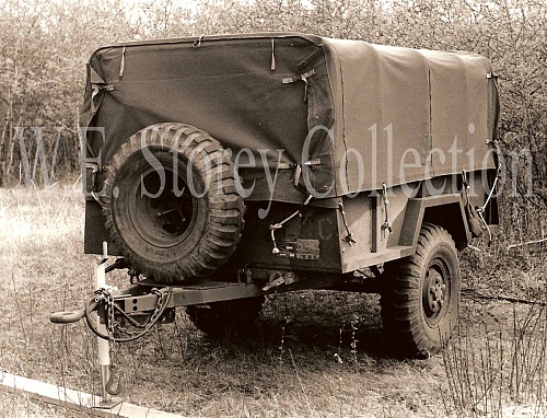

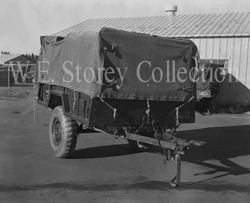

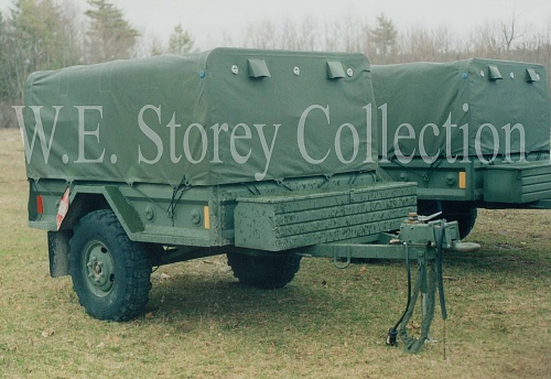

I don't have any record of Canada using M101A2 ¾ Ton Trailers although Canada has employed the M101CDN from CFR years 1951, 1952, 1953, 1968, 1969,
Name:	1. GN71-1617 M101CDN ¾ ton Trailer with water tank - front right oblique view copy.jpg
the M101A1CDN from CFR years 1968, 1969,
Name:	2. 62-35 M101A1CDN Trailer, front left view, RV83, CFB Wainwright, Alberta copy.jpg
the Manac M101CDN1 from CFR year 1981 and
Name:	3. 62-33 M101CDN1 44242 copy.jpg
