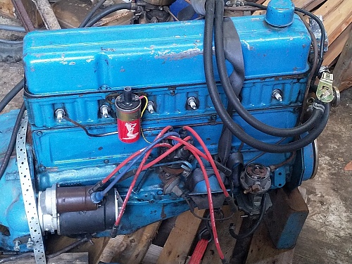

Hi all.
I have found conflicting information on this new blue flame I have recently acquired in regards to pedigree. It has a R type engine number that I read was problematic. Here are the details with Pic's to follow. Thanks for the help.

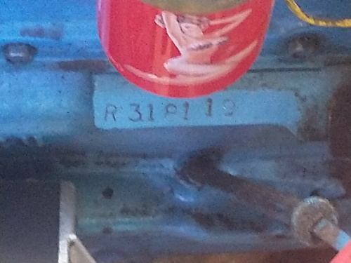

Engine Number: R318119

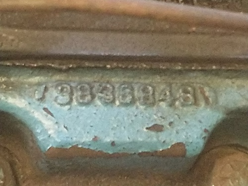

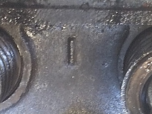

Head cast number. 3836848 Head does seem to have a single "|" Bar
Block Cast Number: 3738307 ( May be 3738807)
Engine
Name:	blue flame.jpg
Engine No
Head cast
Head Bar

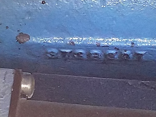

Block cast No

We'll, I can't tell you too much other than this seems to be the last series of 235 Blue Flame engine, a 1958-62 engine with Hydraulic lifters. These engines are rated at 125Hp. The head is the famous '848 head that can also be used on the 261 engine block to give higher compression.
I agree with Lang that the "R" in the serial number in this case indicates a factory supplied "Replacement" block, so while a '58-'62 build, it was put into an older vehicle by a Holden or Chev dealer.

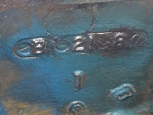

The engine above in question was found to have a couple of severe cracks on the engine block around the welsh plugs rendering the block unsuitable for the blitz. I have sourced another block and another engine which I will post in another reply. I did however find another I Bar beneath the block build stamp.
I understand the II is for a 261 but anyone know why there would be a single I bar on the block and the head . The block ID is below:
Thanks for your help.

The group of markings in your photo above are the marks that the foundry use to enable them to keep track of which blocks were cast on particular days or from a particular batch of iron. If there are problems they can then isolate affected batches.
The number 3738307 is the drawing number of the casting. The finished block would have a part number depending on the exact way it was machined. Thus a block with blank pads for an accessory would have a different part number in the factory to one with them drilled and tapped but that number would not be stamped into the block usually. Notice that the actual engine number is stamped into the machined pad but the casting and production batch numbers are cast into the block, not stamped. You can't stamp a raised number ! The casting number is only changed if the un-machined casting changes, so extra features would get a new number whether it was an extra pad for a bracket or bigger bores or different water ways.
