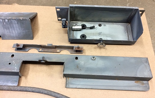

Saved from MLU some time ago for a Chev
Name:	Radio Supression Kit 1.jpg

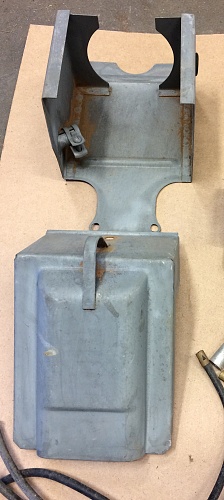

Rectangular box Regulator cover?
Name:	Radio Supression Kit 2.jpg

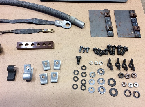

Name:	Radio Supression Kit 3.jpg

I had these photos hidden away on an external drive
I don't seem to have saved the instructions on how to fit it
Hopefully someone has them, I need them too cheers rod

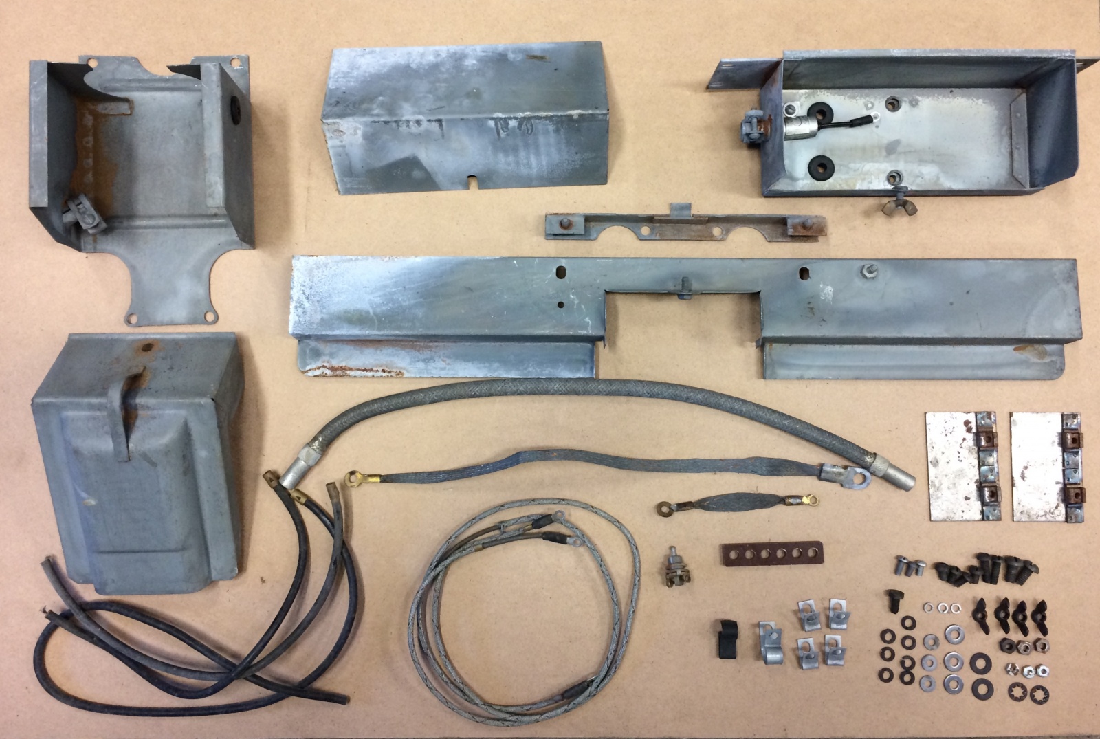

Old 17-12-19, 01:02
Posts: 4,189
Those were my pictures of the full kit. I’ve got the instructions as well. I’ll get them scanned and posted in the next day or so.
Old 17-12-19, 09:03
Join Date: Feb 2004
Location: Beek Holland
Posts: 425
thanks , I have the screening parts , but I am wondering the correct way for the wiring.
Those parts look mint .
Old 17-12-19, 14:38
Posts: 4,189
The parts are mint. Unissued set.
