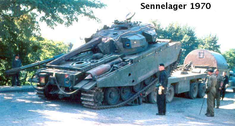

Old 28-07-13, 01:32
Dan Martel's Avatar
Centurion nut
Location: Mississauga
Posts: 233
Mile,
Just by happenstance I was surfing through the site 'ruhrmemories.ca' this week. It's been completely revamped and has had some new photographs added. Two of the new photographs show the rear deck of the Centurion tank with 105mm Type B barrels. In both the turrets are reversed and the barrels are clamped to deck.
After seeing these I think I know what you mean by the Depression Stop Rail and how (and why) the clamp, or crutch, had to be moved. The DSR are the rubber pads that outline the top edge of the engine deck, while the clamp was moved to the left rear side to accommodate the fume extractor.
Am I on the right track? (No pun intended.)
Dan.
Old 28-07-13, 02:23
Posts: 2,402
Dan,
Interesting images. The B&W image shows three Centurions: the two in the background have 105mm Main armament (fume extractor is not concentric, and is square edged), while the closest is a 20-pdr with the rounded, concentric fume extractor and a single counterweight for balance.
Cents from at least Mk.3 onwards had the gun crutch on the rear left corner of the hull. The mod was required because the diameter of the B type barrel was slightly larger at that point than the A type barrel. The crutch had to be enlarged just a fraction (but not moved).
The colour image shows a Cent with 20pdr main armament moving onto or off (most probably off: no ground guide on the trailer deck directing the driver) a Dyson Mk.3, 50 ton trailer being towed by a Diamond-T tractor.
Mike C
Old 28-07-13, 04:16
Dan Martel's Avatar
Centurion nut
Posts: 233
Mike,
I will gladly defer to your obvious familiarity with the Centurion, but if I may I would like to play the Devil's Advocate for just a minute. Further to the first photo, I had to crop it down to fit into the window. The actual photo is 1600px and shows an entire squadron of tanks aboard the train. None of the other barrels are visible, but the camouflage pattern of the vehicles suggests that the photo was taken after the July, 1965, changeover to 105mm L7 guns. For that reason I can't understand why there would be any 20-pdr armed tanks still being used.
The second photo is dated 1970, but I'll admit that the lack of a camouflage paint job on the tank makes the probable photograph date much earlier.
Again, thanks for the new information in your reply. If you don't mind, I still have some more bone questions to ask about the Centurion.
Where Type B barrels created from Type A's as a refit at a workshop or depot, or were Type A's and Type B's produced as such at the factory?
I had always thought, obviously in error, that the exterior of the 20-pdr and 105mm barrel was the same (Type A or B), and that it was only the interior sleeve that needed to be changed to increase the bore by 21mm. Wrong again?
I have a couple of other questions that I have never been able to find an answer to, that I would be embarrassed to ask on an open forum. May I contact you via email for an answer?
Dan
Old 28-07-13, 06:26
Posts: 2,402
Hi Dan,
Yes, please PM me if you wish.
To answer your questions and queries, the closest tank is armed with a 20-pdr: no 'ifs' or 'buts'. Besides the fume extractor being a 20pdr type (and with the counterweight welded along the top), the mantlet is not fitted with a .50 cal Ranging Machine Gun as were most Mks of Cent fitted with the L7 (the exception is the Brit Mk.6).
As to the change over date, like most changeovers, it took time. In the case of the Canadian Army, Dingwall states that not all were changed to the 107mm L7 tank gun anyway. Is this/are these Canadian images? Both Mk.5 (and Mk5/1) with 20pdr and Mk.11 with 105mm were in service at the same time until the Centurion fleet was finally withdrawn from service in the 1970s. So it would be possible to have both on a train somewhere, I suppose.
The Type A was not converted to Type B. Type A production stopped when Type B production started. I believe Type C was the conversion of Type A to using a fume extractor, but as Type C were never used in Australia, I have not investigated this aspect in detail .
The 105mm L7 does not have a type letter: it came in only one configuration with the eccentric fume extractor. These were all new production barrels. They do fit the 20-pdr breech block. Except for the breech fit portion, I believe the L7 is a slightly larger external diameter at any given point than the 20pdr Type B barrel, and are also larger than the same given point on a Type A barrel (based on a comparison of 105mm L7 fitted to Leopard AS1 and type B barrels fitted to Centurion Mk.5/1).
Mike C

Default Close up
Keith, as far as I'm aware, the Ford 10 was not used in the Cent as a replacement.
I think the Coomandook Cent is 169042: it has quite a history. Don't know the ARN of the one in your images, Tony.
Dan: scratch my comment about a Mk.7: it's a Mk.5 or 5/1 hull with 'crap' hanging off the air outlet louvre plate. 'Phone is in the normal position.

Hi Mike
I have had a close look at the ARN number but can't read them all. I have done some close up shots so maybe this may assist you make it out.
Tony

Old 10-08-13, 15:37
Matt McMahon
Location: Oberon NSW
Posts: 180
Hi Mike and gents, Its the oil cooler standing between the turret bins, They hinge at the front
Kind regards
Old 10-08-13, 21:05
Posts: 2,402
Matt,
Yes, of course it is! My error.... It also well illustrates why there are several reports of damage to oil coolers by rotating the turret without first checking that all was clear. In all cases, the offending 'rotator' was charged with 'negligence: member to pay' - an expensive lapse of concentration for a lowly Trooper.
Thanks, Matt: just shows that 'hand on' experience is priceless.
